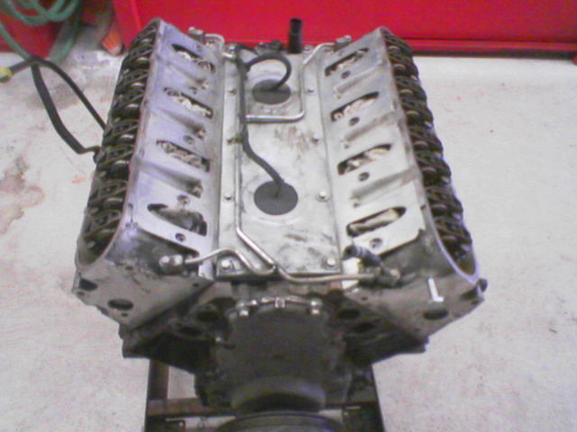

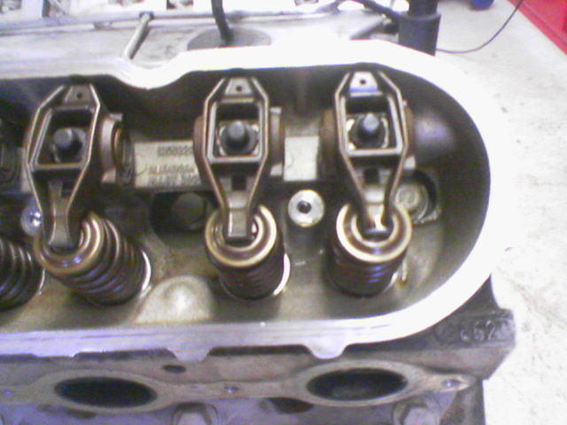

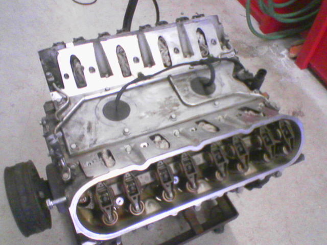

Not a 350, but a build nonetheless (He ended up putting this in a mid 90's S10):
Originally Posted by camaro1
this is going to be my winter buget build,
ebay $350 gm 5.3L(326 ci) (converted to carb)
gm LS1 hot cam and valve springs
edelbrock carb intake, holley 750 or edelbrock 800 carb
whats is going in?? not sure yet
Attached Thumbnails My First Engine Build..Help Please-pic27.jpg   My First Engine Build..Help Please-pic28.jpg   My First Engine Build..Help Please-pic29.jpg
