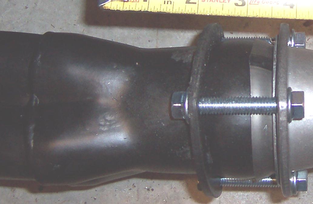

Originally Posted by BLACK Z
I have aleak where the four tubes meet on the pass side at the colletor, I was wondering is it possiable to weld down in there it seems pretty tight...
If they are like these hedmans they are welded from the open end of the collector as shown in this pic when they are assembled. It's a tricky weld which probably explains the leak. If the headers have a long collector pipe, you may have to cut off the collector, repair the weld, then weld the collector back on. In this pic, there is a reducer to 2-1/2 bolted on the flange so it isn't this tight. I suggest using a MIG welder.
Good luck.
