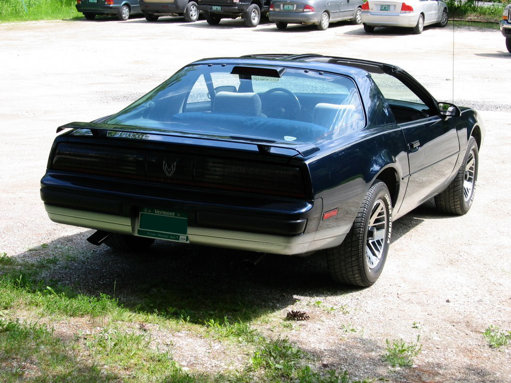

I have a 1986 Firebird S/E. The "S/E" part is the Special Edition. The RPO codes call it a "Trans AM". (For some reason, it doesn't even have a Pontiac arrowhead on it, either?) 86 was the last year of the S/E trim level, and they only made 2,000 or so of them. I have the 2.8, T-5, Posi 3.42 rearend and WS6 suspension package, plus the fancy tinted "jeweled" all-red tails. The interior has a leather wheel and shift ****, two-tone cloth seats and dashboard, with the full gauge package, 6-speaker system with factory subs and amp in the sail panels.
