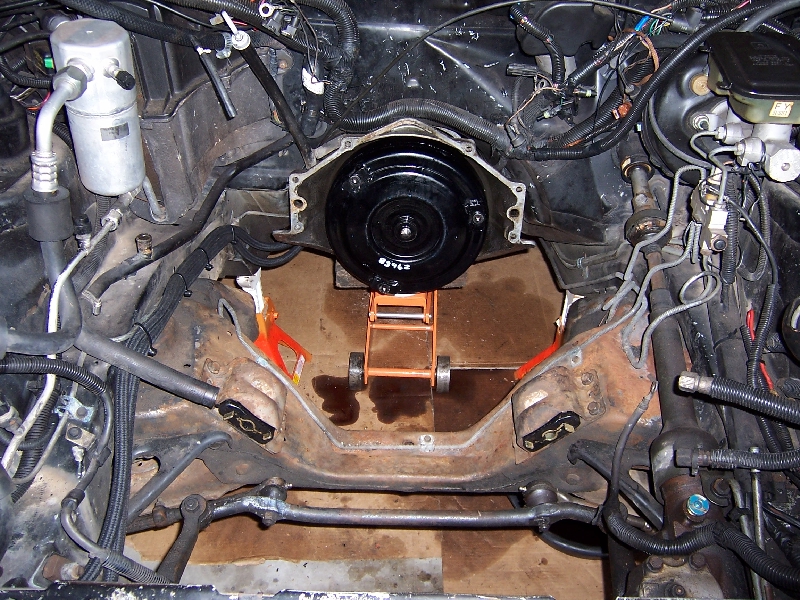

On the other hand, if you do them with the A-arms in place (like I did), buy some "disposable" long 15mm box end wrenches that you can bend to match the nut head inside the box beam of the front crossmember.
It's a labor of love but rubber "ages" and most folks just say "the heck with it" and have an engine that flops around on 20 year old rubber.
Here's mine after about 2 hours of toil:
Last edited by Supervisor42; Dec 12, 2006 at 07:26 PM. Reason: P.S. Tywraps on the trans cooler lines won't work with header heat BTW...
