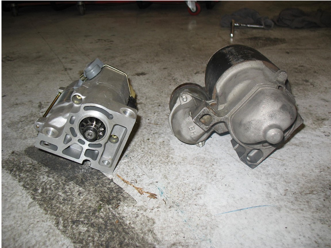

As you can see, there is a big difference in size. The weight is about a 1/3 of the original.

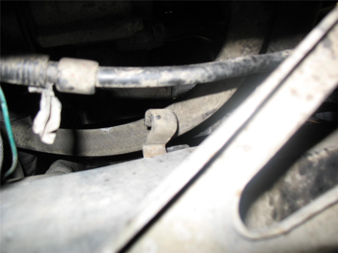

Here is where I had to unclip the positive lead so it would reach. This had to be done because of the shorter starter length. I will eventually install a new positive cable that is longer and reinstall it back into this clip, but zip ties work good for now.
