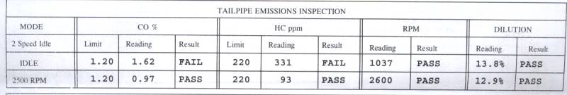

yay! just failed emissions . test results inside , any input please :(
just got this 88 iroc with a 350 tpi . before i went for the emissions i changed the oil , o2 sensor , and gave it a tune up . they ran it twice so here are both reports . the car does not spit any engine codes , other than that i dont know much about the car because i have only had it about a week , as far as i know the car is stock .
any input on getting this to pass is appreciated .

Could be a bad cat or somthing got disconnected on your emissions. Check all lines to the smog pump and such to make sure its all hooked up.

Was the car plenty hot at the time of the test? It seems to have gotten better with the second test. HC is caused by unburnt fuel or incomplete combustion. That is usually caused by a skip, misfire, or rich condition.
Your numbers are very close. Do you run a 190 degree thermostat? a 160can keep things just cool enuff to cause trouble.
If you do run a 190 and teh car was properly warmed up , i would look at the cat. It might be reaching the end of its service life.

The fact that it is idling at 1037 RPM is an indication something is not right. It should be idling around 600 RPM when warm. Put a vacuum gauge on the car it should be in the 18-24 inches of Mercury range or 30 Kpa if you can find a metric one. If the vacuume is right check to make sure the timing is at 6 degrees. People like to jack the timing up on these cars for better performance.

i was in the exact situation about 3 weeks ago and my car (88 tpi) failed emissions, it actually only failed in Hydro Carbons (HC) on IDLE. DId a complete tune up; set timing to stock settings (4 degrees advanced), wires, cap and rotor, o2 sensor, sparks plugs (put the delco's back on), etc etc. And......... the car still scored the same, it failed. Then i replaced the high flow cat with just a universal 3inch cat and my HC were cut in half. And it pass in all categories extremely well.
However, I don't really know why your idle is soo high. Check your lines and fix them and check / adjust your timing back to stock setting about 4 - 6 degrees.
Hope this helps.

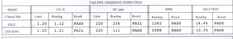

well this proves to me that emissions testing is bull**** . tossed a $65 crappy universal cat on it and it passed . here is the report .

ya , that is were it went . fixed that , set the timing to 5 degrees and ajusted the tps before the 3rd try and it still failed . thats why i broke down and did the cat .
