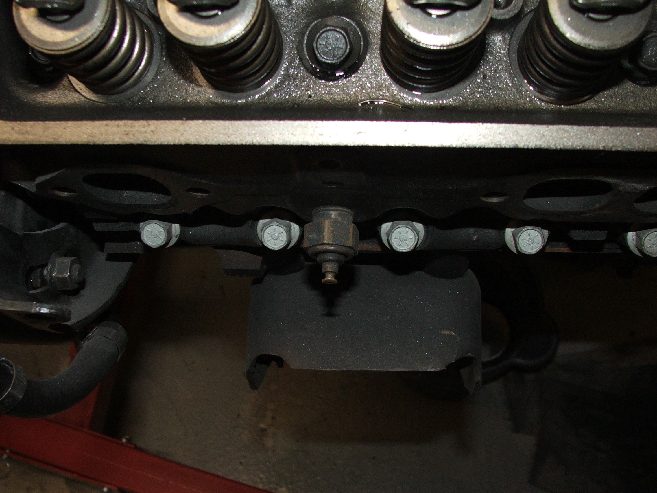

should the sensor look like this? or is it the one with 2 prongs inside that the connector plugs into?

That is the temp sensor for the gauge. The two pronge is for the computer.
