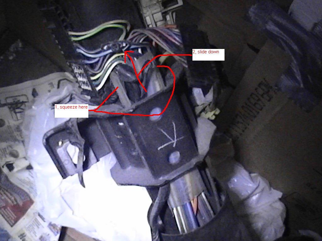

you may have a different type of sleeve than this, if you do let me know.
if you have one like in this picture, the sleeve can be pulled down.
first unhook the wiring connectors from any brackets they may be hooked to, next squeeze the end together & then slid it down.
at this point you should be able to pull the connectors through with out too much trouble.
if you save this pic to your computer & open it with windows picture & fax viewer, you can zoom in for better detail.

This is what I have. The first picture shows the end of it, and the seconded shows how far the sleeve goes up.

its been quite a while sense the last time i seen that type of sleeve.
i believe you will need pull that bracket completely off, first loosen the 4 bolts holding it to the column. you need to hold the column up for this next part, its not heavy so you can do it with 1 hand while you remove the 2 nuts, once you get the nuts off you can let the column hang down, it won't hurt anything unless you have an in dash gear indicator. now pull the 4 bolts out, with the bracket off, the sleeve should for the most part be hanging free now, look closely at it & look for an opening. if there is not an opening, you will need to cut it open down one side. the connectors should come out of the column now, the big ones will need to be turned a certain way to come out & go back in.
if you have to cut the sleeve open, reuse it by putting the wires back in it & then wrap some electrical tape around the it, it doesn't need to be tight, the wires need to be able to move around in the sleeve.

Wow, once I took off that bracket the rest was easy. It had the opening all the way down it. However I have 2 more questions and I hope I wont have any more. The first question is about putting the bearings back in. One side of the metal has a lip, do I put them in so the lips are closest to each other? That’s how they were on mine.

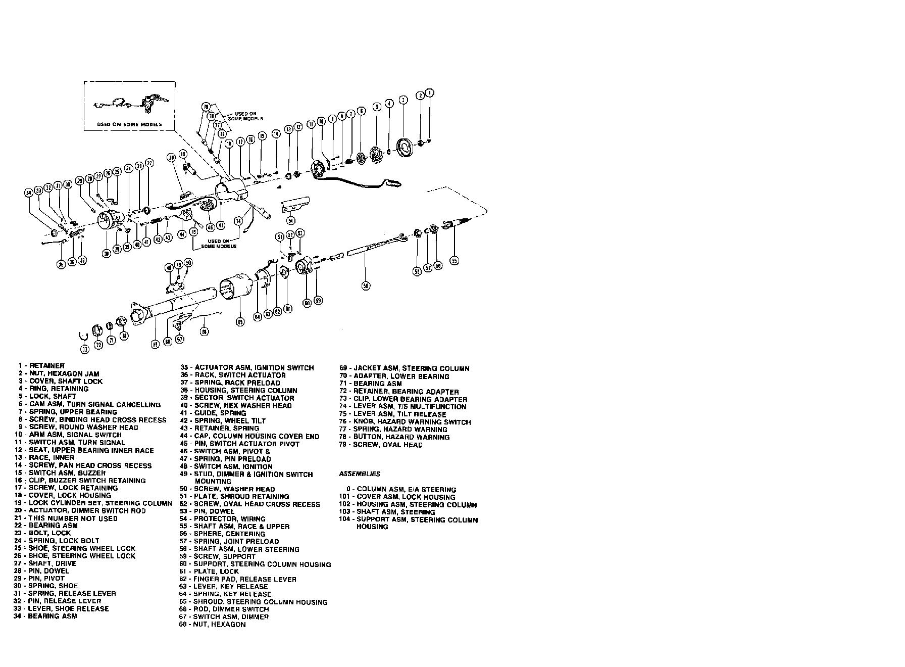

When I went to the GM parts store they had a part explosion diagram of the steering column and I thought that would be a good thing to have for assembly. Does anyone have that diagram?
Now DENN_SHAH you have helped me so much with this. With out you I would have been very lost. THANK YOU!!!! For all the help!

this is the best exploded view i have, its a column for a standard trans.
