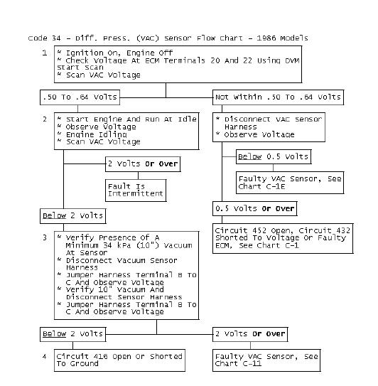

ok theres 2 flow charts, one for 86 and one for 87
i'll post the one for 87 later, gotta go to class

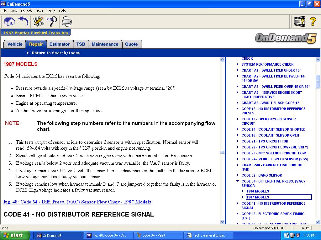

here is the 1987 service info and flow chart
i spent 15 more minutes doing this than i needed to lol. hope ur happy

sweet looks like i get to find out what my ecm looks like. would my 84 ecm be the same as an 87 as far as trubbleshooting goes

yeah i was wondering that, i wasnt sure if u used the 87 ECM or not. i looked up an 84 and it was the same as the 86 i believe
