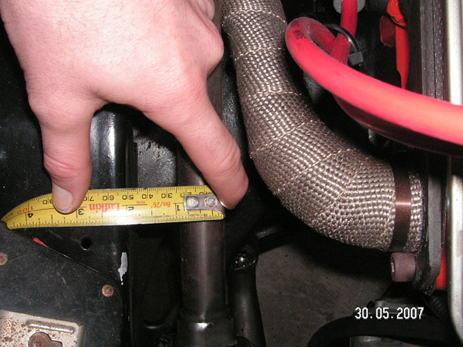

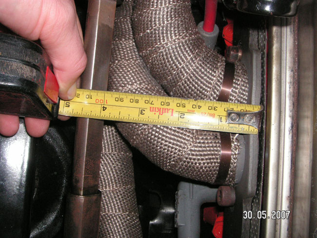

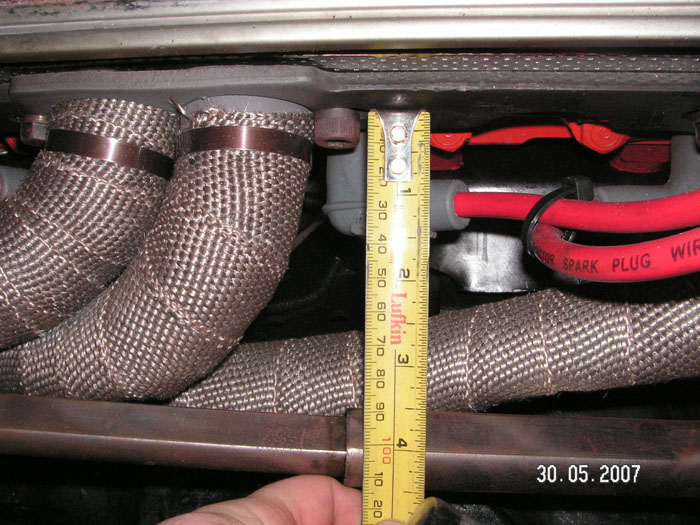

RHD Column pics for you down under guys lookin to run summit/flowtech headers.
My clearance issues are in part the shaft being a little far over. I just about need a feeler guage between the uni joint and the headers to check clearance!
Enjoy!
BTW, all you northern hemishpere types should thank your lucky stars you don't have to put up with this type of crap to this extent. It ain't fun.

Thanks dude, this is really useful. Looks like I'm gonna have the same troubles as you when I come to fit headers though, because my measurements are about the same.
Now what would be really useful is precise measurements of the various headers available on the market... but I don't think I'm gonna get that!

Ah I see. From the look of it, the steering box rag joint is forward of the no 2 primary pipe, and shouldn't interfere. However the second joint between the lower and intermediate shafts stick out similar to the rag joint, I think to mount the stock plastic shroud that covers the lower shaft.
In the third pic on post #1, Aussiroc seems to have used a more streamlined uni joint. I suspect however, that headers like the Hooker 2055, 2460, or Hedman 68470, will stick out more than the 100mm available between head and shaft shown in pic 2. These would interfere with the shaft no matter what diameter is.
