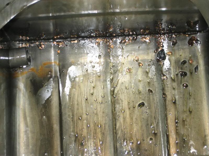

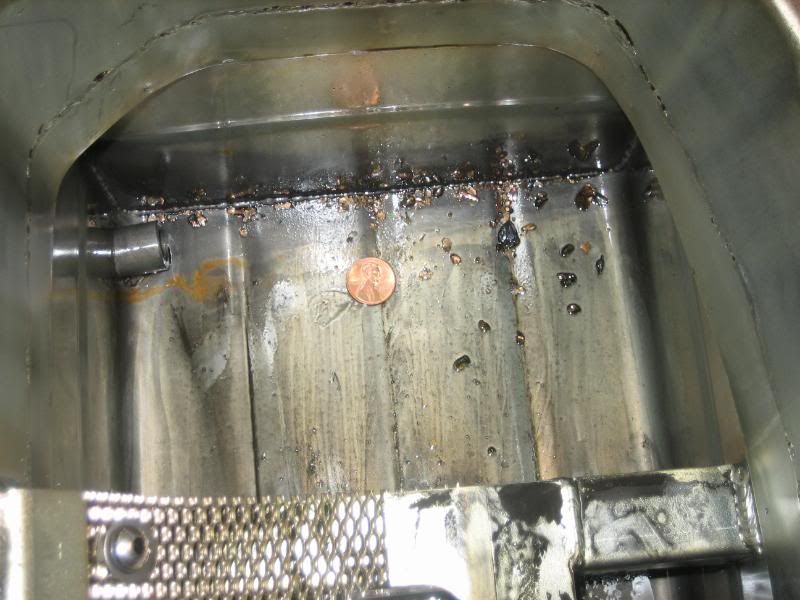

ok!>.....heres some pictures of the oil pan....I just took it off an hr ago
I havent rolled the motor over yet to look at the rods or anything else, I'll do that when I get home from the gym. WHat should I do? pop all the rod caps off? doent matter huh? the whole motors gotta come apart?
looks nice huh! what is that stuff?

Looks like something didn't have enough clearance, so it decided to make more.

Ouch!!
I feel your pain.
Most of it looks like bearing material.

Hi there,
Gym? is not enough exercise for you been under the car for hours?
I see brass color there and the only thing that I can think that is from brass in an engine are the fittings, it is at the oil, so check the brass fitting of the oil pressure take off.
Perhaps some fitting was broke during the installation and did come at the oil passages.
That's a "penny", and it looks like this is going to cost you a pretty one. . .
I'll second the "pull it apart" recommendation. For one, you circulated metallic particles throughout your oiling system (I know there is a pickup screen and oil filter, but they only stop so much). For another, something caused this, and you really need to find out what it was.

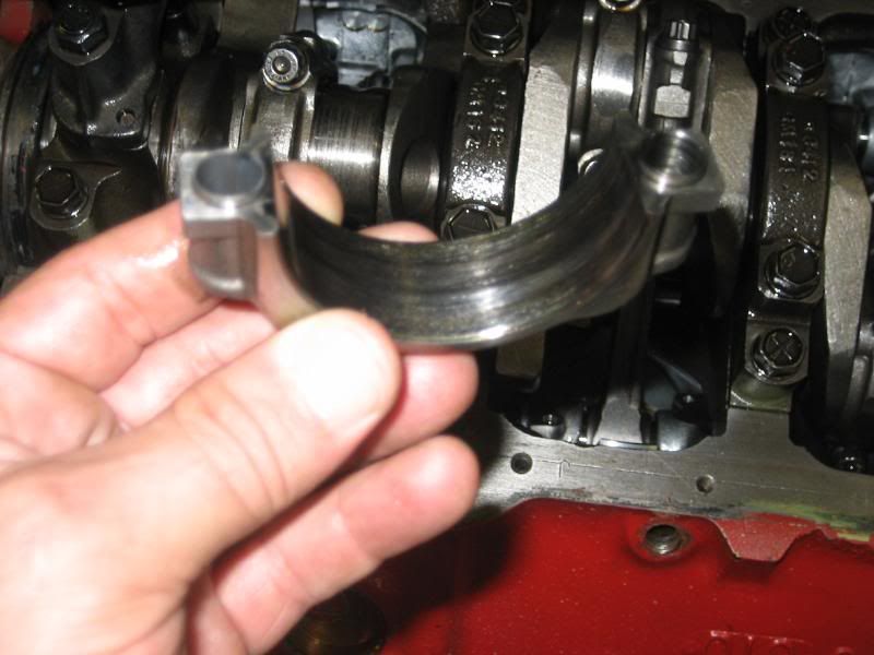

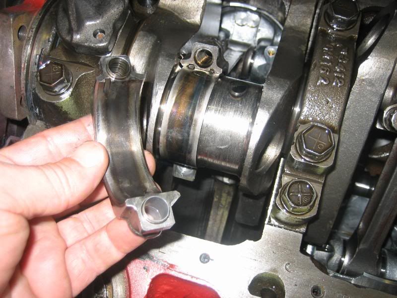

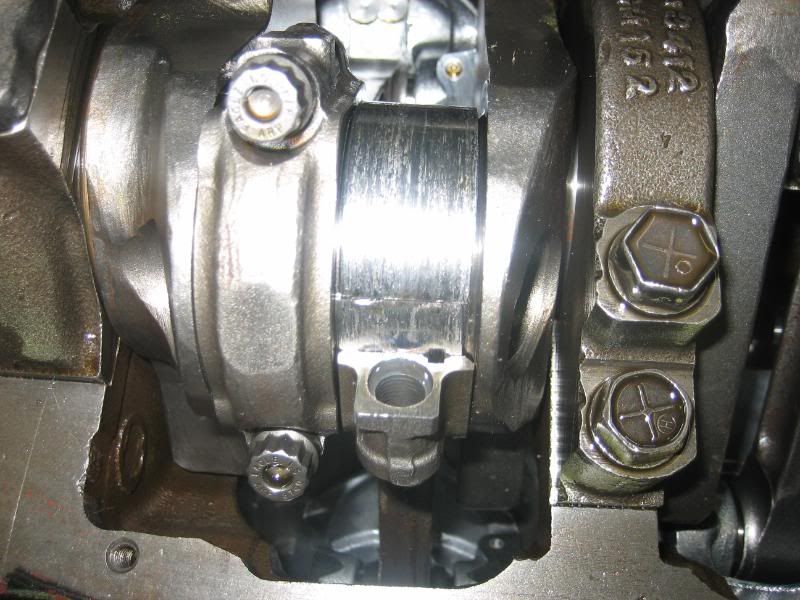

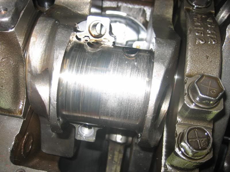

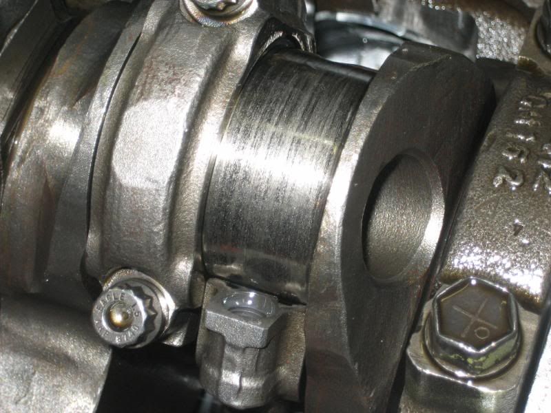

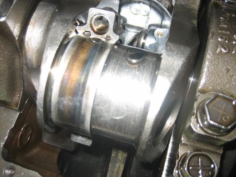

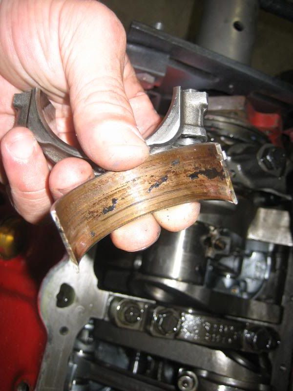

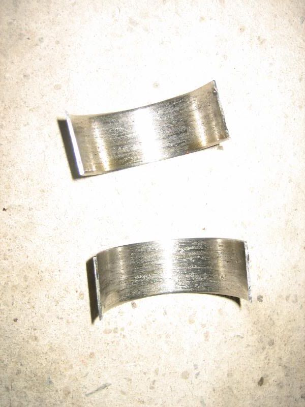

ok, sorry Im late but I need to buy a 12point 7/16ths socket to get the rod bolts off...but here's the pictures, I took them as I pull the cap off....WTF?
ok, now how are bearing put in? are they is 2 pieces? Im new at the rod bearing part of the motor. can some one explain?
I know they are suppose to be smooth, right? and Im assuming they are not suppose to be in 2 pieces? or are they? one cut is clean like it was meant to be there and other is jagged like it snapped apart.
well heres the pictures, you tell me?
whats the hole in the crank journal? is that suppose to be there?

Re: all I can do is laugh!!! Motor gone!..LONG
Yea, bearings are in halfs. Only the cam bearings are in one piece.
The parting line should be at the same point as the parting line of the rod cap.
Can you catch a fingernail on the crank journal? I'm guessing so...
The hole in the crank journal is how it pumps oil to the bearings, totally normal.
Can you get a close up of the one bearing that looks like it snapped? If the parting line of the bearing isn't where the cap is, then it "spun". See how there is a "tang" in the caps? that matches a tang on the bearing, holds it in place. If it's not in place then....

Very good pictures of a spun bearing. Notice no tangs on inserts .

Doesn't look like it's been getting any oil.
No need for the fingernail test. That journal is wiped out.
I have said that truly spun bearings are rare - well, here's one.
As you take more apart, something tells me you're going to find at least one more gone. Maybe a main bearing as well.
Or, the bearings weren't put in the rod correctly when the engine was assembled.

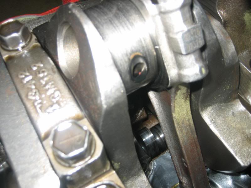

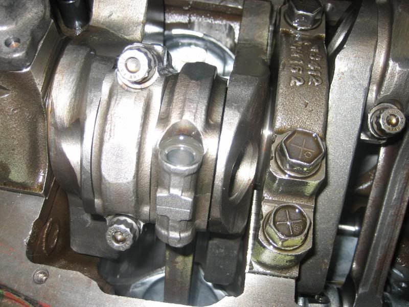

what is up with the #8 rod looks like it is huge on that journal...which side is that rod offset to a main journal or the rod journal

Im getting good at taking pictures. SOmeone should rename this thread cause im assuming its showing everyone what I spun bearing looks like and sounds like.
anyways, yeah the nook is gone on the #7 bearing. and I took #8 cap off just to see and heres what I found on that one. When I took the bolts out I had that grey looking matter all over my hands. You know the real fine metal dust and I was think WTH? so heres what I found when on #8..and it smelt burnt. All these are #8....look at the different color from the #7 bearing, why? they are both spun or just one burnt? and yeah those are chunks taken out of the inside...of the bearing on 8...

Looking at your first pictures, you can see the #8 cap is discolored. Those puppies got hot.
Looks like you're in for some rod work, too.

well I guess we have figured out my bottom end is toast? eh?
so what is next? what should I do? how much work are we talking about or should I just buy a new stroker kit? which would be cheaper?
should I ust get a new crank and rods? how much is forged? should I go forged or keep what I got?
Im gonna be hittin this with a 100-150 shot
My condolences.
That #8 has been running hot, it was ready to join #7. The rod cap should be same color all the way across, basically silver.
You're gonna need to have those rods checked, they may have expanded especially the #7 since it obviously spun. The crank doesnt look real good either, in fact given the condition of the bearings... ugh.
Yea, good chance it ran dry before with the high pickup and thats when all the damage was done. I'd say all the bearings are gone, based on those 2 and the other information. Who built the motor and who put the deep pan on with a shallow pickup?
As for the parts, your choice. The crank may clean up with little work, I cant say just looking at it. They have small oversize bearings so if it was STD, may be able to run a slight oversize. The rods can be fixed, resize them. What they do is pull that alignment dowel, grind the mating faces, and hone the thing out to size. It'd be a lot cheaper than buying another set of those rods for sure. As you get into the motor you may find other damage, for sure the cam bearings are going to show signs as well. Hopefully the cylinder walls are ok.
