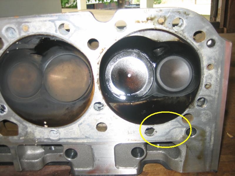

well I just disasembled the motor down to the short block.. I left the rods and all still asembled.
Heres a picture of the number 7 piston and head. I just need to remove the balancer and the timing cover/ timing gears and then Im going to pull the cam out and see what the lobes and bearing journals look like on that. Then Im going to go up the road and talk with a machine shp and ask then how much they would charge me to fix the short block.
#7 piston
#7 valves
#4,6,8 pistons
I dont know where the liquid came from. its not gas seems like water..maybe it leaked in there when I had the motor rolled upside down or something or NO I just thought of, maybe its the water that was left in the jackets on the head and it leaked in there.

I don't know! but something say to me that Piston #7 is not right.
Looking to the picture is has a round impression on it (top left) that doesn't belong to a piston.
The bottom side of the pictures it shows also a nice fluid clean part that isn't normal too.
Looks like the gasket was blown long time ago and did left some spots at the piston.
The head is OK from this distance but it shows also a deformation of the gasket and probably during installation. Look to the bottom bolt (at the picture) the marks left by the head gasket.

I just went out there and looked atthe #7 piston. there is no impression on it from the valve...it must just be the lighting but yeah, there is that one spot that is completly clean all the rest of the piston has that carbon build up except that one place....whys that?

Check the pictures with the mark-up's
Ask others for their experiences on this but from here I can say that is not normal the clean spot and the dot shaped thing.
Probably this was the start of the problems.

the clean spot is where the piston was slapping the head, same thing happened on my brother's motor.

ah...yes I can see now where the head imprint is on the piston. Im assuming that because of the #7 bearing being gone and allowing for the extra travel? SO the piston is OK, right? doesnt looked damged at all just clean on that spot.
and as far as the head gasket imprint, I dont get it? I dont understand what your talking about
oh and hey, that top left mark on the piston is where, I touched it...if you could zoom close enough you would have my finger print!...LOL

OK! I see.
Once the bearing goat the play the piston was kissing the head and the shape match the head combustion chamber.

Originally Posted by Wishmaster's87IROC
asn as far as the head gasket imprint, I dont get it? I dont understand what your talking about
Looks good!
Sorry for the imprint, I though that the bolt was pushed thought the gasket and did shifted the gasket.
But looking in more detail it seams to be OK.
I think that your finger touch did misleading me in this case. Sorry for that.
Don't want to introduce problems!
Regards,
Cobra289
