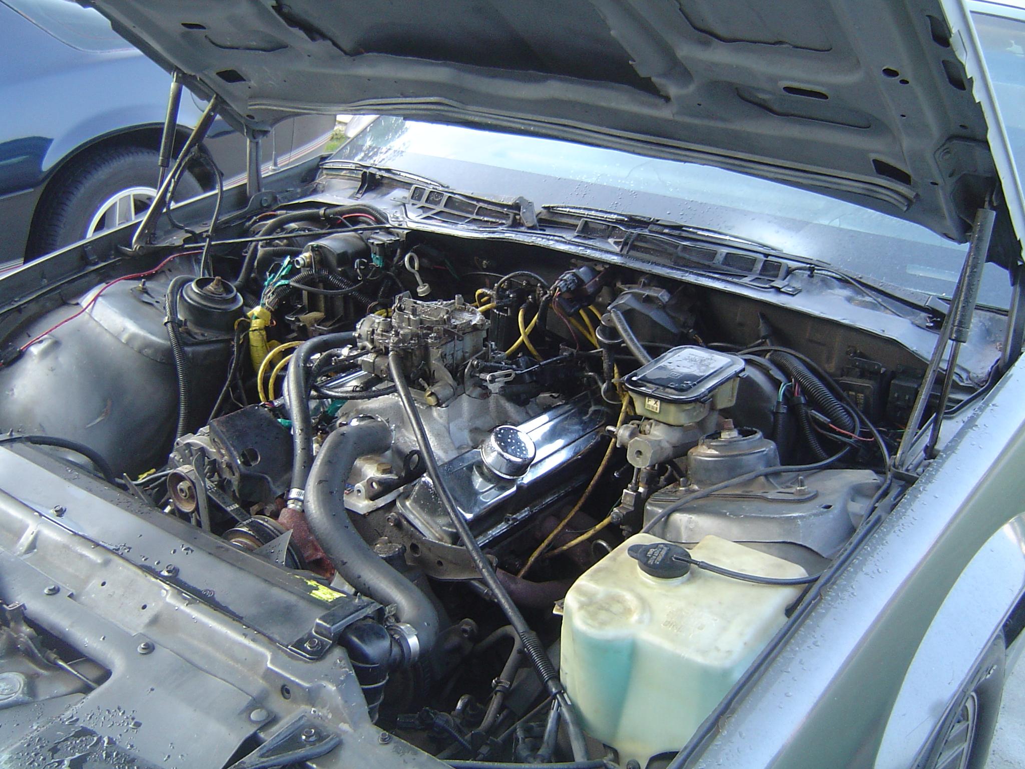

'87 Z28 for $500. One of my buddy's employees bought it and could never get it running right. He drove it for a few weeks then it started cutting out after 10-15 minutes of running and refused to restart. I haven't looked at it yet.
Anyway, everything you shouldn't do to one of these puppies is here in one package...the conversion to mechanical q-jet with the computer controlled dist; swap to a 70's era small block with the driver's side dipstick; the much covetted 993 heads (w/dual valve springs no less); the A/C delete mod; chrome valve covers-oil pan-tstat housing; EPS manifold with spacer for the spreadbore q-jet; electric fan to mechanical conversion (at least all the wiring's present) and the rare gas pedal delete-you try backing it onto a tow dolly with your hand stretched down trying to give it gas by pulling the cable---
Told myself I didn't have time for another project but sometimes it's meant to be. Follow my progress as I delve in and the fate of this ride is determined: JY or DD?
Attached Thumbnails Project car to daily driver?-z28-engine.jpg   Project car to daily driver?-z28ext.jpg   Project car to daily driver?-z28int.jpg

Originally Posted by naf
'...the conversion to mechanical q-jet with the computer controlled dist...
Just hook up an external TPS. . .
To answer your question - DD.

Aside from what you mentioned, that looks like it's in pretty good shape - for $500. You know what needs to be fixed, i'd give'r!
Of course i'd recommend you sell the much coveted 993 heads to someone who's looking for numbers matching heads for their mid '70s vette.

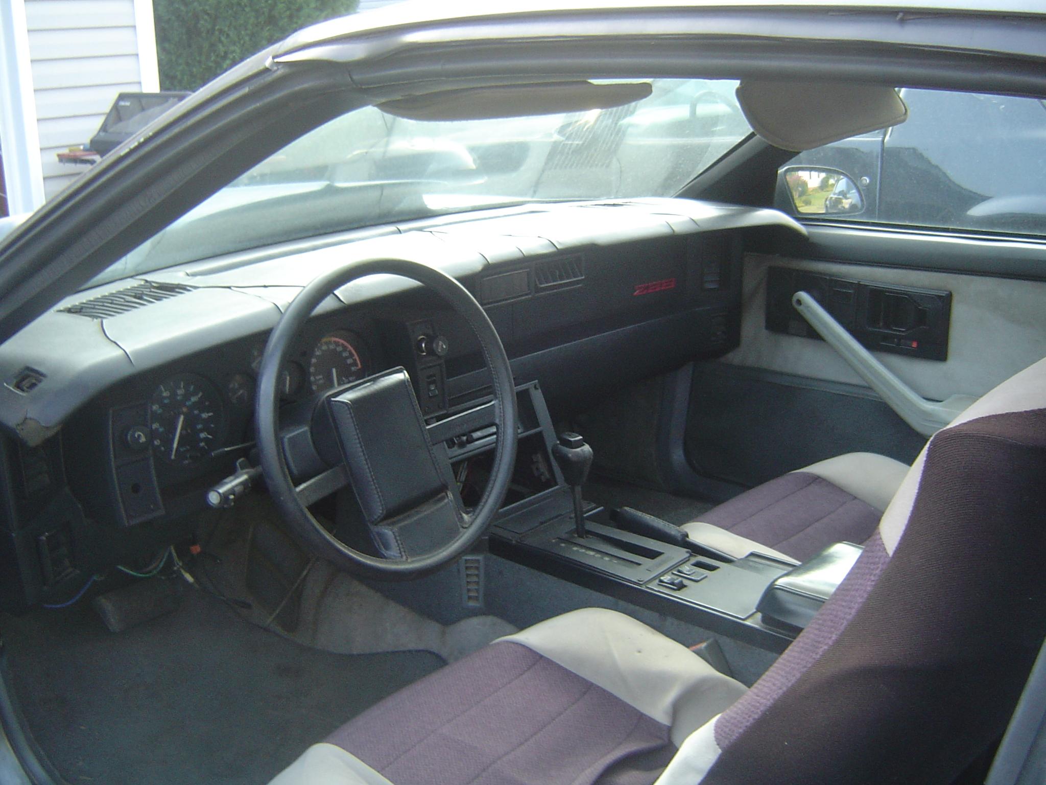

It looks clean on the outside...
And it really freaked me out when I looked at the interior picture and saw the really screwed up reflection in the passenger mirror. It took me a few seconds to figure out why that reflection botherd me and then I had to make sure I wasn't crazy... LOL.

Maybe not the first place to start but I was really afraid the steering wheel might actually fall off maneuvering it around the driveway. Never seen one this loose before. Pulled it all apart and the bottom two tilt screws had to be fished out of the rear of the housing and the top two were 2-3 turns loose. $13 for a new ignition cylinder so far (the old one was missing the 'wings'). 'Course once I got it together up to installing the new cylinder I saw the ignition switch cam preload spring laying there...I'll finish tonite hopefully.
Was too hot all weekend to do any work around a running engine. I mean it's been 'Africa-Hot' down here.

Hey i looked at you're picture looks like ur missing a coolant resevoir.?? am i wrong?

Yeah, it's missing the coolant reservoir. When I get to that point I'll probably buy a new one for the SC and swap over the dingy one.

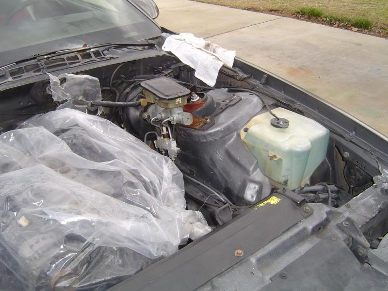

Motor in but not yet fired up. The only two weekends I've had off since January (until now) have been saturated with rain. Got to button up a few small items and clock the dist/plugs/wires and I should be able to crank her week after next when I'm off again.
The header had an O2 bung in it but it had to be cut through the pipe. Plasma cutter at work. Rebuilt most of the wiring harness but still need the evap controls and some pigtails but that won't stop it from running. Placed the rebuilt carb on my 85 to check it and it fired up and idled fine without any adjustments. Was responding a little rich but operating in feedback mode.
Spent a little time sanding and spraying the bay-just around the fenderwells and nose-not too crazy. Just used some Duplicolor touch up gray, wasn't worth mixing, spraying and cleaning.

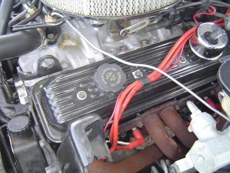

Fired up a few weeks ago but had some loose ends to finish up this past weekend before I could drive it. The computer controlled carb took only a minimal amount of adjustments to the idle mixture screws and IAB to start working in feedback mode. KS still needs to be hooked up (I need to scour the JYs for a 350 KS and ESC-don't want to pay cost of new).
EGR valve is used and probably not working so I've got timing set near zero. Was having some light pinging under throttle at low cruise with the initial setting near 6.
I made an attempt to save the cowl hood. As I started sanding through the grey primer I kept hitting surface rust on the metal everywhere. A lot of rust was coming through the primer anyway. I just shot what was there with some black epoxy primer. Not sure it's worth trying to save. With as much metal as they cut away underneath it would probably eventually crack anyway.
Power steering pump: $40-(I busted the old one pulling the motor), power steering pump brackets: $10, used tires (that came off my 87 SC when I got it) mounted: $48, alignment: $50. Idler arm: $30. Replaced all the tie rods and center link with slightly used stuff: $0. Copper line for the mechanical oil pressure guage: $10 (sunpro guage set was given to me by a neighbor-I don't trust the little plastic lines that come with the kit). CD player (radio doesn't work) came out of my SC.

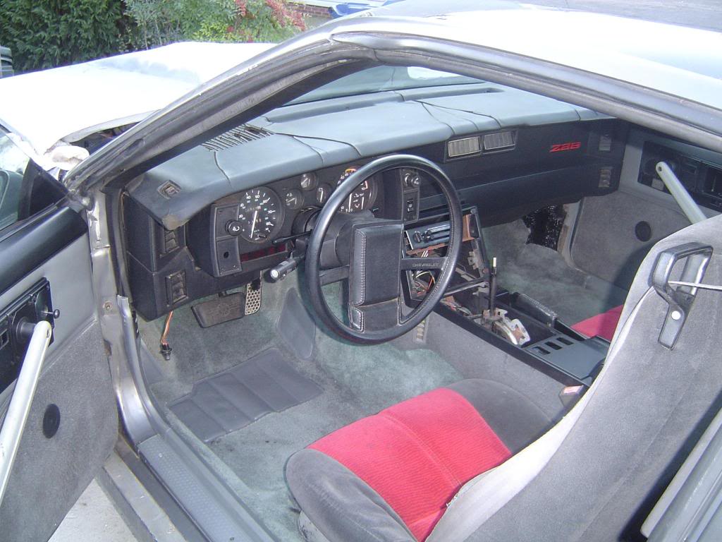

Interior with cracked dash pad that came from my SC:

Trick plug wire holder for centerbolt valve covers: $0.79
