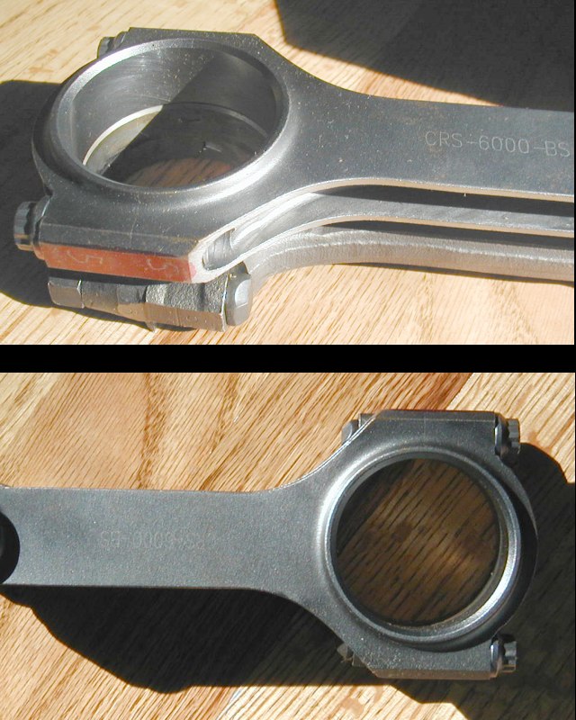

Putting a cam in a 383 without know what rod clearances you have is risky business.
Just a word to the wise.

You do NOT need a small base circle cam. Do NOT listen to anyone who says that you do. You a standard base circle now with .558 lift and are stepping down. So tell me why in the hell you would need a small base circle cam.....
Measure a pushrod, this can give you an idea of if the base circle on your current cam is smaller than stock. I'm sure your builder clearance the rod bolt shoulders plenty if he had any idea whatsoever of what he was doing.

"Stepping down" makes the cam lobes LARGER.
Think about it.... cam lobes are made as absolutely tall on the nose as they can possibly be, and still fit through the cam bearings, so that the cam can be installed. That's basic mechanical engineering, for wear, strength, etc.: make the part as large as it can be.
Lift is the difference between the height of the nose and the height of the heel.
Therefore, the "bigger" the cam, the "smaller" the heel; because the nose is ALWAYS the same height. That's also why you can take a worn cam, and re-grind it "bigger": you just grind more off of the heel than the nose.
Also, the cam's timing has as much to do with whether rods will hit it, as it does with lift. That can be difficult to predict.
You can't tell anything at all about the cam by measuring a push rod, especially with aftermarket heads; and ESPECIALLY ESPECIALLY with TF heads. They are notorious for needing attention to that detail. Who knows if whatever "deviation" from "normal" that one might find, is due to cam base circle, valve length, valve location in the head, etc. etc. etc.
SBC cams are ground on a 1" base circle, usually. The lobes are of course much larger than that.
A "standard" small base circle cam is ground on a .900" base circle. That gives .050" more clearance. Might not sound like alot, but it can be HUGE sometimes.
However, in the case of the Crower cam, it's not really very much smaller (larger diameter heel part of the lobes) at all, because the lift is pretty close to .550 on the exhaust side IIRC.
As a builder myself, I NEVER EVER touched rod bolts for clearance, except as a VERY LAST resort. However in Dennis' case, the rods might not even have bolts at all; they might be cap screws. I don't know that.

alright then, according to you its fine then. From the highest point of the lobe is the same, which is where it would contact the rod. So therefore, it'll be okay.
Whatever.....
Whatever.....
Posts: 28,023
Likes: 2,496
Re: What should I do, my engine builder disappeared
No, the highest point is NOT where it will contact the rod.
The point where it will contact the rod is when the rod bolt is up in the cam tunnel (around 45° from TDC on whichever side of TDC, depending on whether it's a left-bank or a right-bank rod).
If you examine a cam's profile in relation to crank position, you will quickly and easily see that the tip of a lobe is NOWHERE NEAR pointed right straight at the rod at that point. Some other part of the lobe is there waiting for the rod to come up and hit it.
Keep in mind also, that advancing or retarding the cam will change the intake lobe's tendency to interfere with the rods; and both that, AND the LSA ground into the cam, will determine the exhaust lobe's issues.
So, what "will be OK"? What's "fine then"? What are you talking about?

Here is the bottom end of my motor
Looks liek I have bolts and not cap screws. Is that bad? You made it seem kinda like it is from what you said earlier.
And here is my motor with no heads. Don't know if this helps at all but I know sofakingdom you wanted to know how deep into the boerd my pistons were. I know you can't tell if those pistons are at TDC and they probably are not, but thats the only pic I have. But thats another thread and another issue.

Those ARE CAP SCREWS. Those are H-beam connecting rods. bolts go in from "top" of the bottom part of the rod and have a nut on the bottom. Those just thread in from the bottom and give a LOT more clearance....this is good....you will not need a small base circle.

Right; those are cap screws, not bolts & nuts.
They usually give a good bit more clearance than bolt & nut rods.
However, I notice QUITE A BIT of grinding on the block; not a good sign. Most builders don't grind on blocks any more than they have to. That much grinding would tend to indicate that whatever kind of rods they are, their shoulder, i.e. the place where the bolt head would go if they had bolts, may still be kind of tall. In fact, looking at the #3 rod, the only one that you can really see that part of it, it looks kind of tall to me.
On the other hand; here's how much DIFFERENCE there is between an Eagle rod (I think that's what you've got?) and a stock "X" rod. As you can see, the Eagle has nearly ¼" more clearance than this one (a 305/350 rod, though). Unfortunately I don't have a stock 400 rod laying around, outside of a motor, which would tell the tale FOR SURE; since stock 400 rods clear stock base circle cams, then if the Eagle rod was the same size as or smaller than the 400 rod, you'd be able to tell FOR SURE that you do or don't need a small base cam.
If you order the S version but don't need it, nothing bad happens.
If you don't order the S version but DO need it, you're hosed.
I'll leave it up to you to make the choice.
