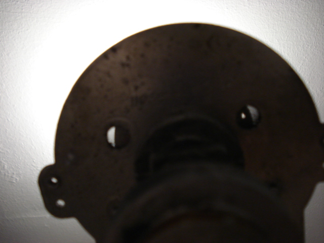

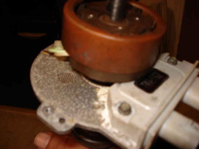

I only use the vacuum grease to seal the distributor ICM and plate to keep moisture from entering from where it shouldn't - this doesn't mean that the distributor is air tight.
Air will enter from breather holes in the plate which are covered with a fine mesh screen.

The problem is pretty well known actually. There's even a note included with new Echlin brand caps sold at Napa. Sealing the cap is the exact opposite of the fix though. According to the Echlin note you should knock the screens out of the bottom plate rgarcia pictured. They say the screens plug up and then don't allow proper venting to remove the moisture.
