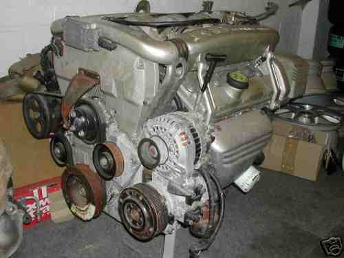

that looks like a ford taurus SHO engine from the 90's i believe it was built by yamaha.the later 90's was a 3.4 liter (kitre) 32v v-8
Joined: Feb 2005
Posts: 162
From: miami
Car: 1983 z28
Engine: '73 4-bolt 350
Transmission: t5
Axle/Gears: 3.42 with auburn and 28 spline axle
Re: HELP!! ENGINE REBUILD 305
i assume you could get a pcm from a taurus to work as well as a harness try ebay for those just be sure its for a sho not regular
allready bidding on a ecu but can't find a harness as yet
