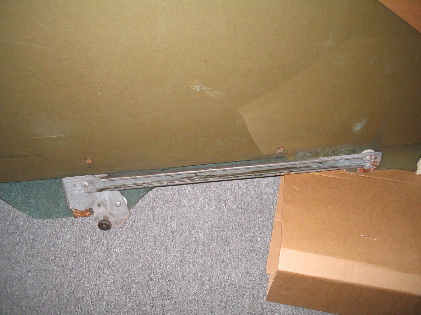

Is this something I will encounter when replacing window? I will upload a few pictures of window for any references.

Well, still need some help here.
I got the door panel off but don't know how to get the old window (or whats left of window) out of the guides or track. All thats left of window is the metal track and roller.
There is a vertical track (sorta near rear of door) that a roller from the window rides in. Then there is a scissor looking thing (looks like a small scissor jack) with small rollers on each end that ride in a horizontal track thats mounted to window.
I have door panel off, small rubber triangle (behind mirror) off, and outer window seal. Also took off two inner furry guides on inner part of door.
I tried to finagle track off in the up and down positions. Messed with it for an hour or so. Can't seem to get it off or even see how it would come off. Thinking I could just hack it off but still would have to get new one back on.
Any help would be great.

you need to remove the regulator and motor from the door to get that track off...and that track needs to be rivited to the new door glass if you don't already have a track on that glass. That is why they suggest a glass shop do this because it's not all that easy. I personally don't know if you can mount the track to the window and then put it in the door, everytime i've tried to take one out still mounted i coudln't figure it out without tearing apart the door, so you may need to re-rivit it to the glass while it's inside the door, then you are going to need to re-install the regulator/motor
that scissor looking thing is your regulator, it's mounted to the motor. To get the regulator uninstalled you need to drill out the 4 rivits holding it in, then move it around and position it to get all the rollers out of the guides so that you can fully get the regulator out to have the max room. Get the glass track out of there, slide the new glass in, rivit the bar to the glass, and then reinstall the regulator. It's not terribly easy, when i said it was easy i missed the part that you were installing new glass. Swapping regulators or replacing motors isn't difficult, but i personally haven't done new glass. That part of it doesn't appear to be all that simple, unless your new glass already has the guide on it, and then i don't know how to get it into the door. Past all that i think i've explained it how it needs to be done...if you go to your local auto supply store they may be able to help you out with the rivits and what not, but personally i'd be hesitant about riviting glass. As far as the rivits for the regulator, i just go to my local pontiac dealer and they got a crap load...they are called regulator/actuator rivits, they are made for the power windows regulators and the power lock actuators.
ok again i do a horible job at reading past posts...it appears you have the track already on the window...you just need to uninstall your regulator by drillling out the 4 rivitis so that you can move the arms around to get it out of that track...then you should be able to get the new glass in there...from there it's just re-installing the regulator with new rivits...should be pretty self evident...any other questions feel free to ask.

All the track stuff is already riveted on new window. Scroll up to one of my previous post as I took a few pictures of new eBay window. Don't know how they got window out. Thinking they just hacked what ever they needed off. Don't know. Would hate to hack track off track on new window if I didn't have to. I was wondering how I was going to get window roller through small door slit. Thanks for your info...
