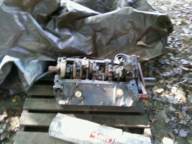

I have had this engine for about 4 months I am not sure what it is the guy said it was rebuilt and that it is a 350. I do not know if it is bored or not or what I should do with it.

You identify a block by its casting number, which is on top of the bell housing flange behind the driver's side head.
Looks to me like yours is a 3970010. Pretty common 350 block casting, probably the most common in fact. Was used from 69 to about 80. Nothing special one way or another.
Plus, using my finely calibrated eyeball micrometer, it looks to me like about the right distance between cylinders for a 350. Too little for a 305, at least; and it's positively not a 400. The pictures are too fuzzy for me to tell if it's been bored, but I'd expect it has, since those don't look like stock pistons. So it's probably AT LEAST .030" over. Measure the bore with a steel ruler; it's 4.000" stock, .030" over is just under 4-1/32", .040" is a little than that, .060" over is just under 4-1/16". A micrometer would of course be even better.

A) check the casting number, and match up to the description at www.mortec.com
B) measure the bores. If its ~4" its a 350, if its ~3.75 its a 305.

The cylinder walls look to me like it's been re-ringed, not re-built.

The block has so many different numbers I just wrote a couple things down..
The cylinder measures 4.1inches
A couple of things it says on the block
^F3412
GM56
010
also on the cylinder it says 080
The bronze things say EPC41B (1 5/8)
3952302 24

for the casting number it says
38GM
3970010

3970010
Gee, I guess I'm not as blind as I thought I might be.
4.1" is WAY too big for it to actually be that. But it definitely sounds like it's been bored, probably .060". As one would expect, looking at those cheeeep cast "rebuilder" pistons.... those guys don't measure crap, they just go as far as it will go and if it's not enough, throw it away. I see VERY VERY few "rebuilder" 350s like that one these days, that are not already .060" out. Used up.
Yours does not appear to be runnable at its current bore, judging by the wear. I can tell you for certain, I would not run that block, at its current bore size; and if it's already .060" over, it will go no farther. Time to throw that block away and get another. No biggie though, you can pick up a roller-able one (87-95 TBI truck) for $100 or so. Pocket change in the overall scheme of rebuilding a motor. The money is not in the core (the big junk thing you're rebuilding); it's in the machine work. Don't try to salvage that one, don't spend even 1¢ on it; trash it and move on.

what is tat number on the piston? I think it says .060 which means it's been bored over that far. I can tell by the new freeze plugs it's rebuilt. Stick some heads on that sucker and run it.

says 080 on the piston

how can I find out for sure?

Measure it with a telescope gauge, and a micrometer. Or, a bore gauge.
