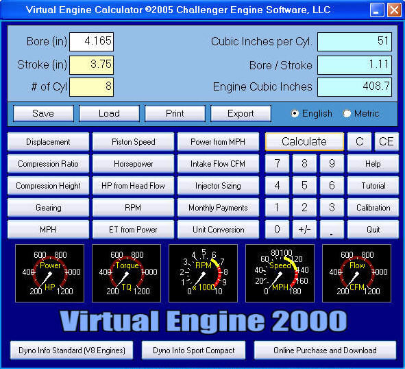

Don't really need another thread for this... But, here ya go.

Pi x (Bore/2)squared x stroke x number of cylinders

its 408 with standard 400 crank

Mathematically correct it should be called a 409. The common designation of408 probably gained popularity to keep from confusing it with the old 409 engines.
