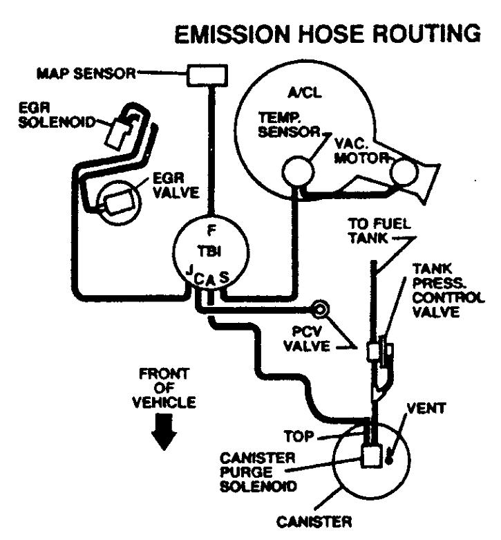

does anyone know how to hook up vacuume lines for 89 camaro tbi??? i took them off cause i did a engine swap but dont remember how they went so if anyne has a diagram or something please healp thank you
