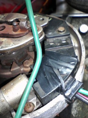

Old May 16, 2008 | 05:47 PM
impaled's Avatar
Joined: Nov 2006
Posts: 504
Car: 1985 Camaro and 1996 Mustang GT
Engine: 350 4bbl/281
Transmission: 700R4/4R70W
Axle/Gears: 9" rear/8.8" 4.10
Re: Still need some help guys...car has no spark
i had the same issue w/ my carbed 350 (i know, totally different engine... etc), i traced all of the wires that plugged into the dist at the bottom and found a short (coating on the wire cracked at that point and the copper was exposed. i took the dist apart and there were also two wires touching in the plug. here is a pic after i did that to mine...
Old May 16, 2008 | 11:32 PM

ok....new problem, while puttting the dist back together somewhere along the line the two holes at the bottom (where the pin goes) well its stuck and we cant get the hole for the pin to line up!! GRRR

that magnetic pick-up he's talking about is like the last resort, meaning that if the rotating pole piece won't stay magnetized, THEN your dizzy is bad.

Get a voltmeter. Unplug the 2 wire connector going to your ignition module. Is there 12 volts at both the pink and the white wire with the key on? Flop the wires around a little while keeping the voltmeter's test lead connected and the key on. Look for fluctuation.

ok guys thanks for the help, ill get out there and check all that....but i do have a question though. once you take off the dist. cap the magnet is on top of the dist inside the teeth. the magnet is scraping on the teeth when its rotating...thats not right is it? sorry.....LOST

The pickup is at the base. On the shaft, theres "teeth", and mounted to the cap base, is the magnet. They should NOT be touching!
If they rub, it won't create electricity very well, if all. The upper bearing in the dizzy could be shot, you need to yank that thing.
I wonder what the gear looks like.......
Before you pull it out, MAKE SURE TO MARK WHERE THE ROTOR IS POINTING!!
This will save you a big headache when you put the new one in.
I'd wait until someone else confirms this though, I could be misunderstanding something.

hi frank hear,im new ,try running a test light to your + side of your coil when your keys on,if it lights comes on means your getting power to your coil,that could mean some thing as simple as your new coil is bad ,it happens

Its HEI, so you have to pull the plug and test the plug.

i think im having the same problem, i have power coming off the coil into the dist, but no spark at the end of the plug wire, changed the ignition modual and cap and rotor, and the rotor does spin when o carnk it, im lost too any updates?

If you have power coming out of the coil, you should have spark, unless you have a bad engine ground.
But, I experienced this same problem last week. I disconnected my battery to do some rewiring for a week, when I reconnected it and tried to start, I didnt have any spark. The battery wasnt in good shape, but I figured if it had the juice to turn it over, then it had the juice to power the ignition. So I charged it up, checked voltage everywhere and I had 200+ volts coming out of the coil. Weird I thought, so I turned it over again and it sputtered, then fired up. I don't know if the ignition system had to "juice up" or what. I'm running all MSD stuff though.
Weird.
Check your coil-dizzy wire to make sure its not arcing on something and make sure the inside of the dizzy is clean. You said you bought a new one though.
I guess make sure your battery is good and charged? There shouldnt be anything stopping you from getting spark, there's really nothing between the coil wire and plugs that would stop spark, except for a lack of juice to jump the plug gap.
