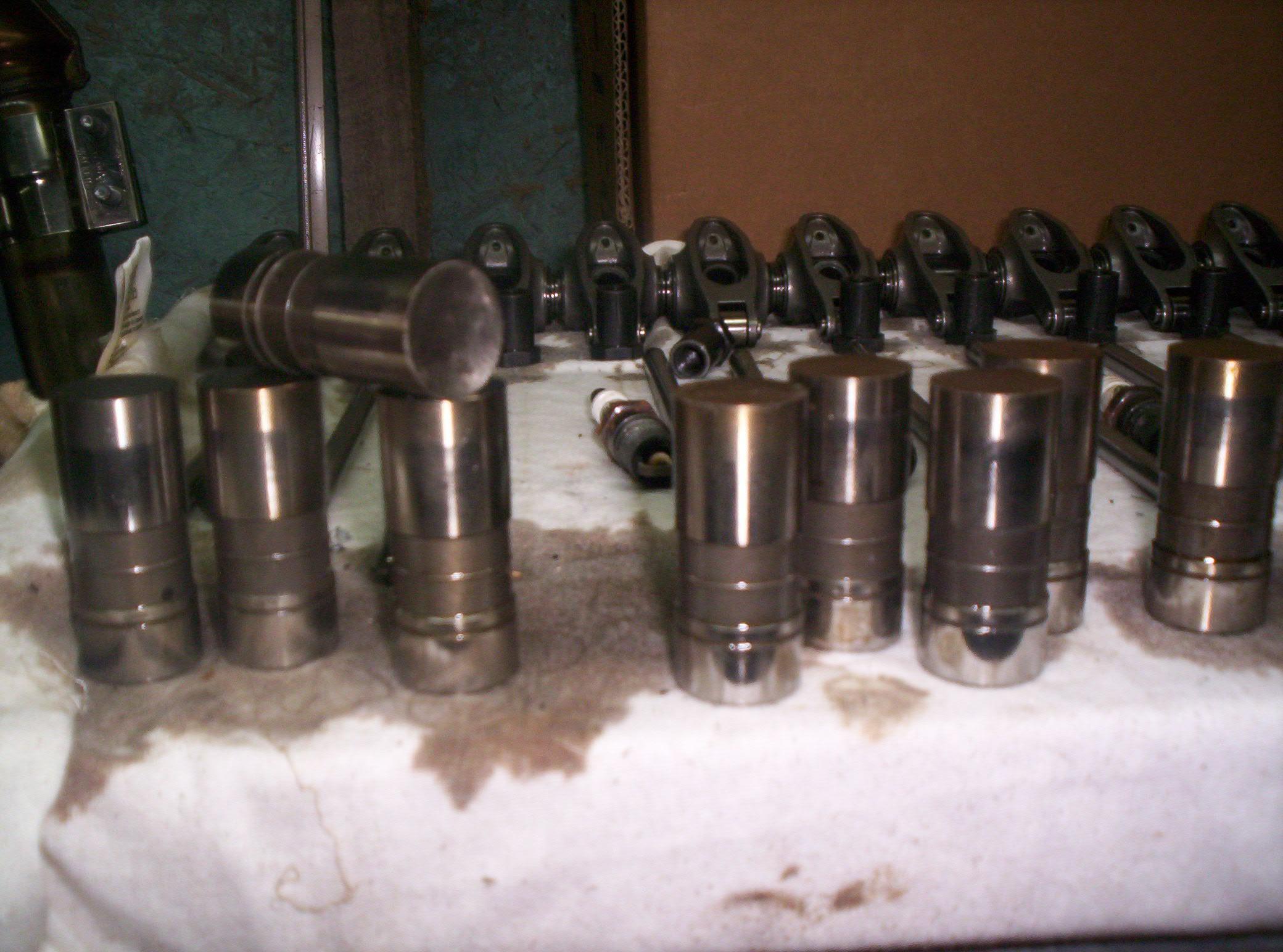

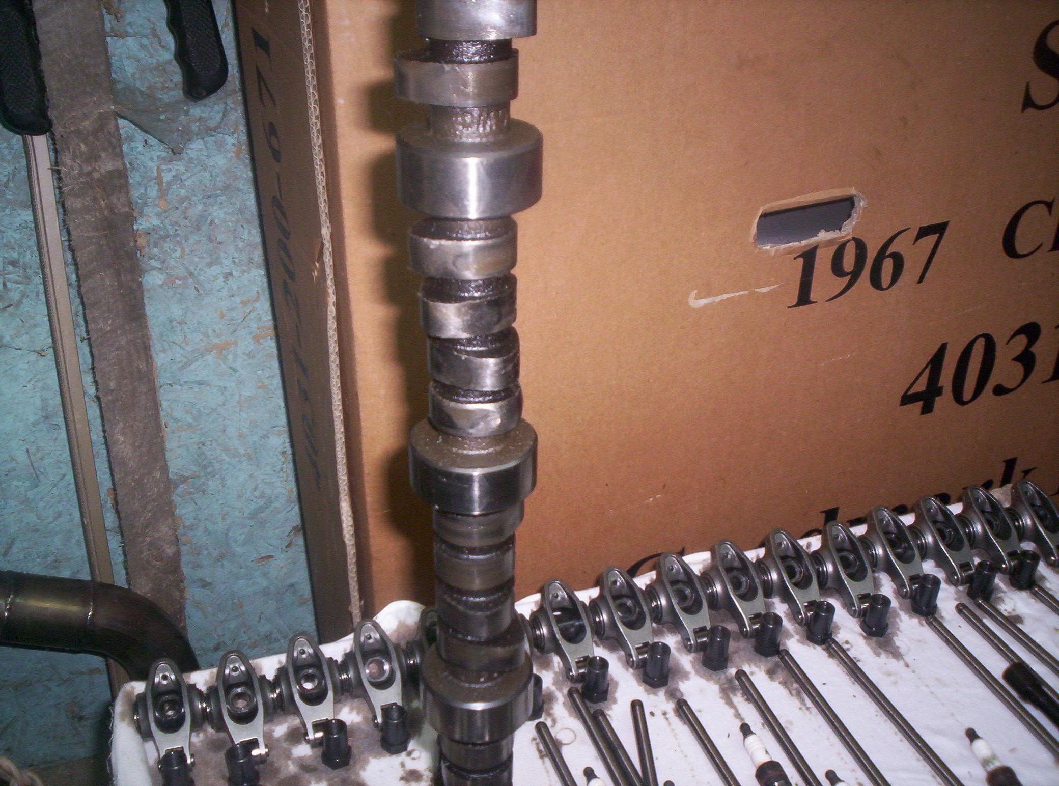

I've wasted a set of OEM hydraulic lifters to the point where the valve lash went out on a couple of cylinders. One of the lifters I removed was completely concave on the cam mating surface. Several lifters were not able to be removed.
I know that there is large amount of lifter and probably camshaft material floating around in the oiling system and has been for some time.(Certainaly a couple of thousand miles).
Has anybody had a similar experience and was a complete disassembly required to flush out the debris? The bottom end on this engine is nice and tight and I'd not rather not have to take it apart..

i have had similar problems wiped 2 cam lobes and 3 lifters in about 50 miles do to excessive spring pressure
a complete rebuild revealed scoring on the main bearings and glitter in the oil obviously also rod bearings were hurting...
it is time to atleast pull it apart

You need to use a zinc additive in every oil change for flat tappets to survive. They took it out of oil to extend the life of catalytic converters.

Yea, I wiped a cam. Full rebuild was needed, my main, rod and cam bearings were scored.
I use GM EOS on every oil change. I find that's the best one.

I've had a noisey lifter or two for at least a season. Turns out those are two of the lifters that are wiped out. I'd think that the debris is well distributed through the engine by now and any damage done is done. I just finished a 2000 mile trip and the engine probably had another 10 000 on it with new 1.6 rockers and bee hive springs. That and the wrong engine oil probably induced the failure. Still that's over 40 000 miles on stock OEM lifters and a little 218 cam.
Anybody had luck with a full solvent flush using a priming tool and then running several oil flushes to get things clean?
I'd also have to pull the lifters out through the cam bore because of the damage. Anyone with experience with that procedure. Get's me to thinking of mushroom flat tappets and how they're replaced.

Already have Comp springs (which contributed to the failure) and Pro Magnum 1.6 rockers. I'm a firm believer in the Made in USA product. It pains me to buy anything offshore.
Set up is not a problem. My shop is fairly well equiped and the procedure is nothing new.
My mistake came from the misconception that after breaking in a flat tappet cam and lifters, I'd be off the hook regarding engine oil specification. It took about 3 or 4000 miles of abusive driving however the combination of the new springs, increased rocker ratio and no oil additives eventually wiped out the lifters.
Live and learn.

A new set of lifters would have been a good idea anyway. I was asking a lot from a tired cam and lifters (+30 000 miles) to hold up to the upgraded valve train.
Incidentaly, WOT is EVERYDAY!

More than likely improper break-in caused the failure, not the oil used (although using a ILSAC GF-4 oil probably hastened the final failure after the improper break-in damage was started).
The likelihood of flat tappet failure after proper break-in when using a quality diesel/gas CF-4+ rated synthetic like AMSOIL Series 3000 HDD 5W-30 (which I just happen to use in my flat tappet engine) is near zero.

The engine has been disassembled and it looks like it's toast. Some of the main bearing shells have little or no bearing material left and the crank main journals are scored.
Several of the lifters are completely concave and one cam lobe is practically just a base circle.
Most of the bearing damage is in the rear mains. They get lubrication first and most of the contaminents too.
The rod bearings fared a little better and the coating on the piston skirts is showing a little wear.
Attached Thumbnails Wasted flat tappets-wasted-bearing.jpg   Wasted flat tappets-wasted-cam.jpg   Wasted flat tappets-wasted-lifter.jpg
Old Jun 29, 2008 | 01:29 PM
SpitotRs305's Avatar
Joined: Oct 2006
Posts: 1,974
Car: 91 RS
Engine: 350 vortec
Axle/Gears: not the best not the worst
Re: Wasted flat tappets
are those solid lifters? as you cant see a single oiling hole... or do you have a part#
and with that kind of localized damage to the cam it seems like you have a clearance problem on those to sets of valves...
Old Jun 29, 2008 | 07:19 PM
skinny z's Avatar
Joined: Dec 2005
Posts: 9,919
Likes: 885
From: 53.0907° N, 113.4695° W
No clearence issues. Just old lifters on an old cam with new bee hive springs. Combine that with today's engine oil and you get what you see.
Factory hydraulic lifters FYI.
Old Jun 29, 2008 | 10:07 PM
  #42
Joined: Oct 2006
Posts: 1,974
Car: 91 RS
Engine: 350 vortec
okay man just looks alot like these
