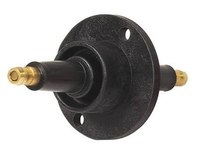

For coil wires, you use a firewall feed-through:
