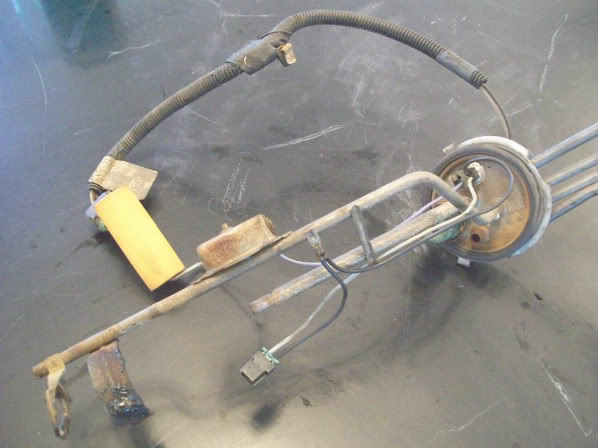

Sorry for the misinformation about the TBI vs TPI injectors, rookie mistake. As far as the injectors go, I don't know. I bought the system from a friend of a friend. He said the car ran great when it was removed, and had some go-fast goodies on it. All I know is that the car ran great until I had my first fuel pump incident, explained below.
I'm positive the pump is designed for TPI, its the BBK version of the Walbro 225. Second one I've put in too....
I changed out the pressure regulator with no luck, still running EXTREMELY low fuel pressure (like less than 30). Thye pump is flowing, trust me its going....got doused pretty good by it yesterday. Its just not building pressure, which leads me to my next piece of the puzzle.....
The first fuel pump (aftermarket, not stock) that I put on lasted me for about 2 weeks, just long enough to get me from South Jersey to Moriarity, New Mexico when the car died suddenly. No indicators, nothing. Just dead. I did a pressure test and figured it was the fuel pump not building pressure. So I called up Summit racing kicking and screaming, and they sent me a new one.
When I pulled the pump out to replace it, I found that it was not the pump...it was a split in the fuel line inside of the tank. If anybody has ever done this, they'll know. The 5 inch long piece of rubber hose that connects the fuel pump to the steel fuel line inside of the tank.
What is happening now seems to be similar to then, except now I have slight pressure (enough to run). If there were a leak in the line, I would know it...unless it were inside of the tank again.
So two possible problems, one is a ruptured fuel line again. Two could be a fuel pump that runs, but doesn't build up enough pressure (which doesn't seem to be the case after seeing the rate of fuel flow from the tank).
Why does it keep rupturing fuel lines? Are they just crappy chinese rubber hoses used by holley (1st pump) and bbk (2nd pump) to save money, or do I have some other problem?
One thing I do know is that the pressure relief valve (mounted above the rear axle, the plastic little vent thing) is stock. I have to go to the dealer to get a new one, Autozone doesn't have it. If it weren't venting properly, there would be a vacuum inside of the fuel tank, whcih I would notice when taking off the gas cap (a hissing noise of air refilling the vacuum inside the tank, air going in not out), whcih I haven't heard.
Either way, looks like I'm pulling the tank out.....again.
Anybody ever have this happen?

That is definitely a problem, get rid of the rubber hose inside of the fuel tank and get a proper sending unit w/metal line from the pump, on up. In these instances, if the pump is good (like your confirming), you need to examine the other areas then, the first being that rubber hose. next of course would be the gas cap, make sure its on and functional. Next would be the regulator, you want to make sure the diaphragm isn't leaking. last, but not least, the injectors themselves. If the injectorsleak, you'll obviously run rich, and pressure will be lower than what it needs to be. First things first, get rid of that rubber hose in the tank....

What is the alternative to the rubber hose? I have to use hose-clamps to secure it to the steel line above and the pump itself below. I was thinking of getting some better hose, rated for fuel and extreme pressure (like 300psi). Even then, I still need to use the hose clamps...what else can I do?
No fuel leaks that I'm aware of, and the regulator is brand new. Just installed it today. Never had a problem with the injectors, so all signs point to inside the tank.
I hate pulling tanks out of these things. One of the biggest engineering flaws by GM on these cars.

Originally Posted by nomad350Z
What is the alternative to the rubber hose?.

That makes much more sense. I still have the TBI sending unit in my car, and the length of metal line running down the the pump is nowhere near as long.
Thanks for the help, I think we just found our problem.
