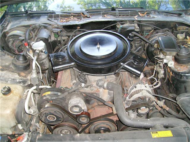

PRETTY NEW TO THE V8 SCENE BUT I LOVE IT...I JUST RECENTLY BOUT A 91 FIREBIRD FORMULA WITH A 5 SPEED..
ANYWAYS I HAVE A FEW QUESTIONS BEEN TRYING TO FIGURE OUT
HOW DO I TELL IF MY CAR IS TBI OR TPI?....
I WAS TOLD IT WAS A 305 BUT WHY ARE SOME PLUGS/WIRES MISSING FROM MY TRANNY? I AHVE A SOME KIND OF PLUG THATS SITTIN IN MY TRANNY BELOW DRIVIERS SIDE WITH NO CONNECTION...DOESN'T SEEM TO AFFECT DRIVING..
ALSO WHY DOES MY SPEEDOMETER DROPS SPEED WHEN I HOT LITTLE BUMPS AND SOMEIMES IT DON'T WORK AT ALL..SEEMS TO WORK BETTER DURING THE RAIN.....
I HAVE UPLOADED A PICTURE OF MY MOTOR......ANY HELP???
ANY HELP WOULD BE APRECIATED ..

Your motor is a tbi engine. A tpi looks like the pic I've attached. Not sure on your trans wiring. Your formula is an electronic speedo, and the wiring down at the trans could be related to your speedo problem.
