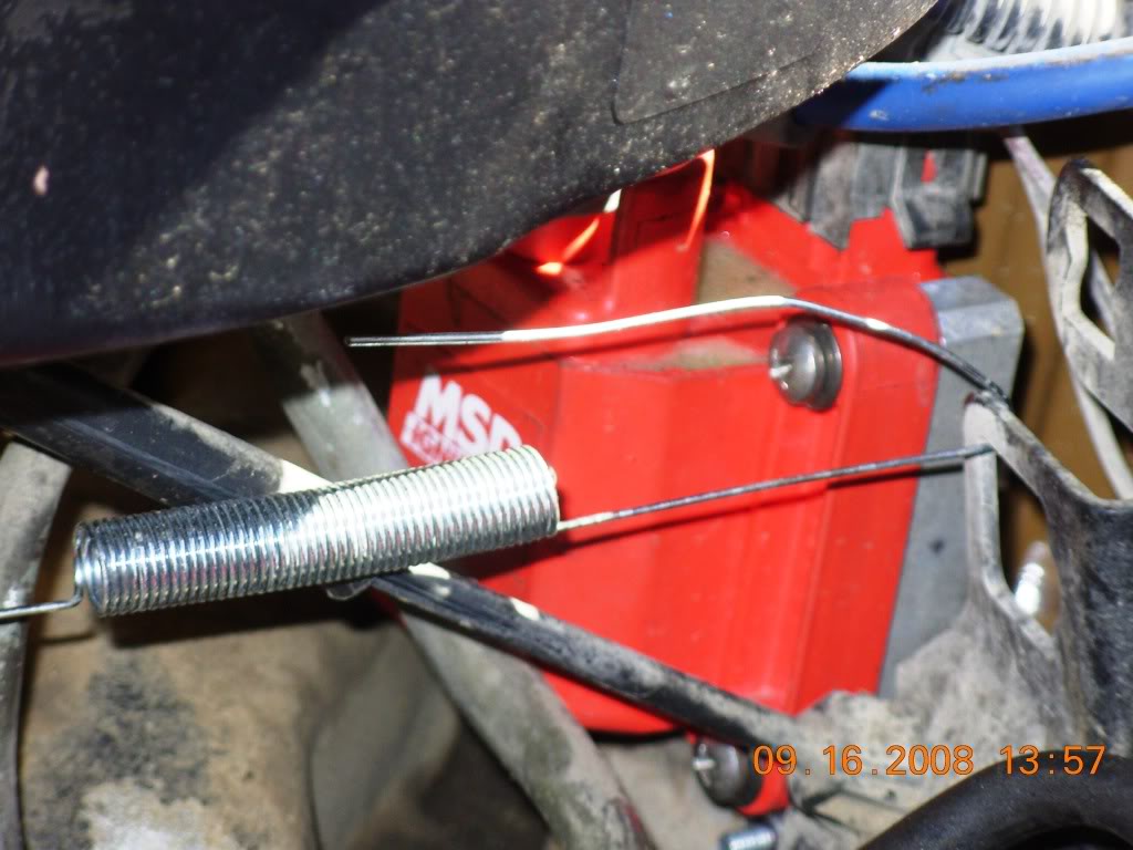

Mine is a TBI, but I have the same MSD coil, so I would assume we have the same factory coil.
The only thing I really encountered any kind of problem with was that the mounting move it slightly forward or backward of the factory one. But it fit just fine. These aren't the greatest but they are pics of mine in my car.
