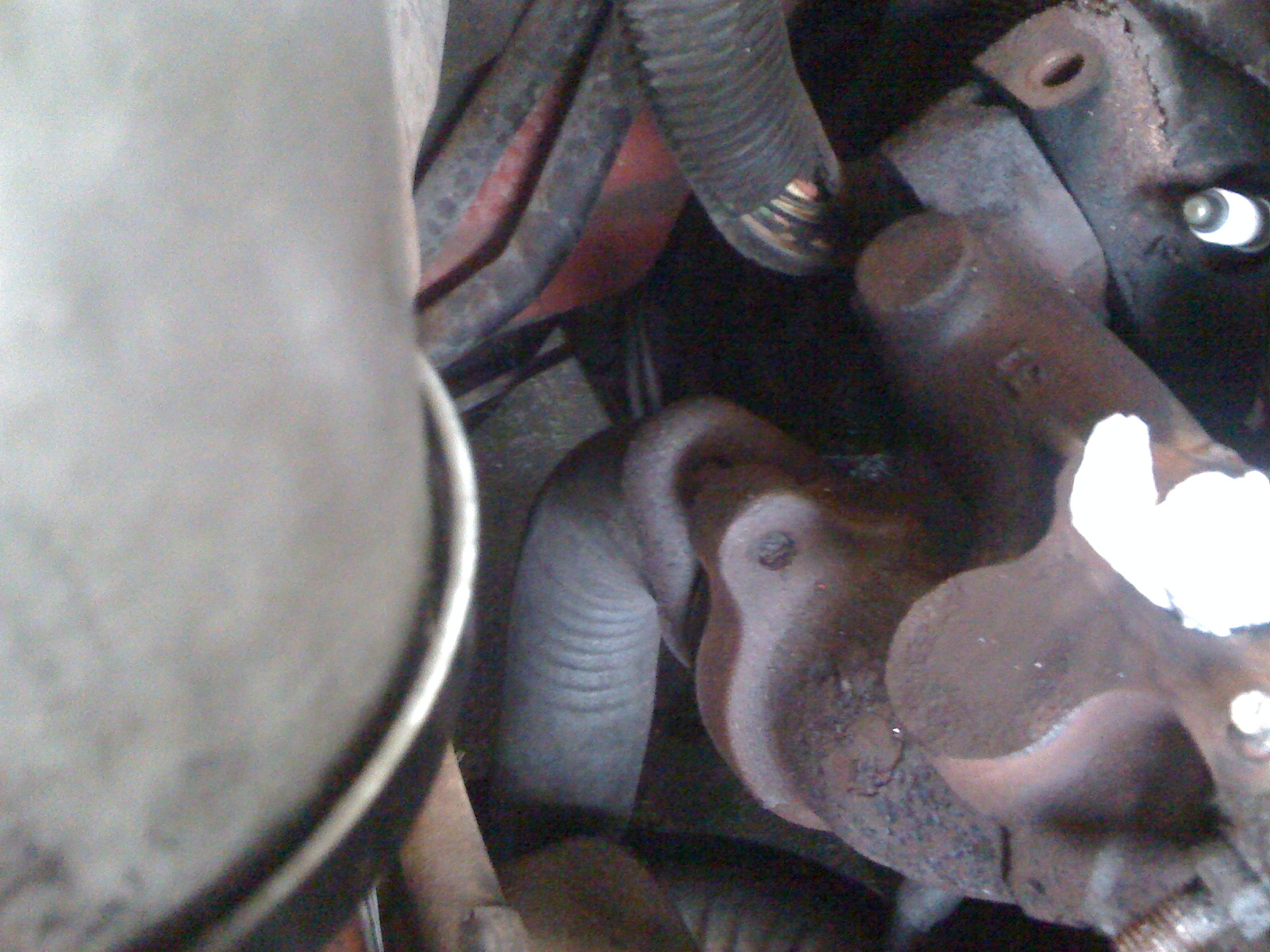

When I was having issues with wiring , it turned out that GM saw fit to run the biggest engine harness right next to the right hand exhaust manifold . When the manifold to head bolt broke and fell out on it's own (seems to be a common failure on our engines) it let hot exhaust gas get blown directly onto the harness and melted it into a short circuited mess ! Yep , fire , being blown onto the wires , how flippin lovely !!! .... Anyway , the fix was , of course , to insulate all the now bare wires , replace the broken bolt , and relocate the harness to be far away from the manifold .
In your situation , we can't be sure it IS wires till you inspect the harness , looking for the kinds of things I found ... The Previous owner of my car $pent considerable $$$ replacing sensors and everything else , except fixing the wiring ! Once I fixed that , it runs like a brand new engine (and it should , with all the new parts )..........
And now , because a picture truly IS worth 10,000 words , here is the section of harness that got fried on my car . I hope your problem is as easy to diagnose !!!!!
