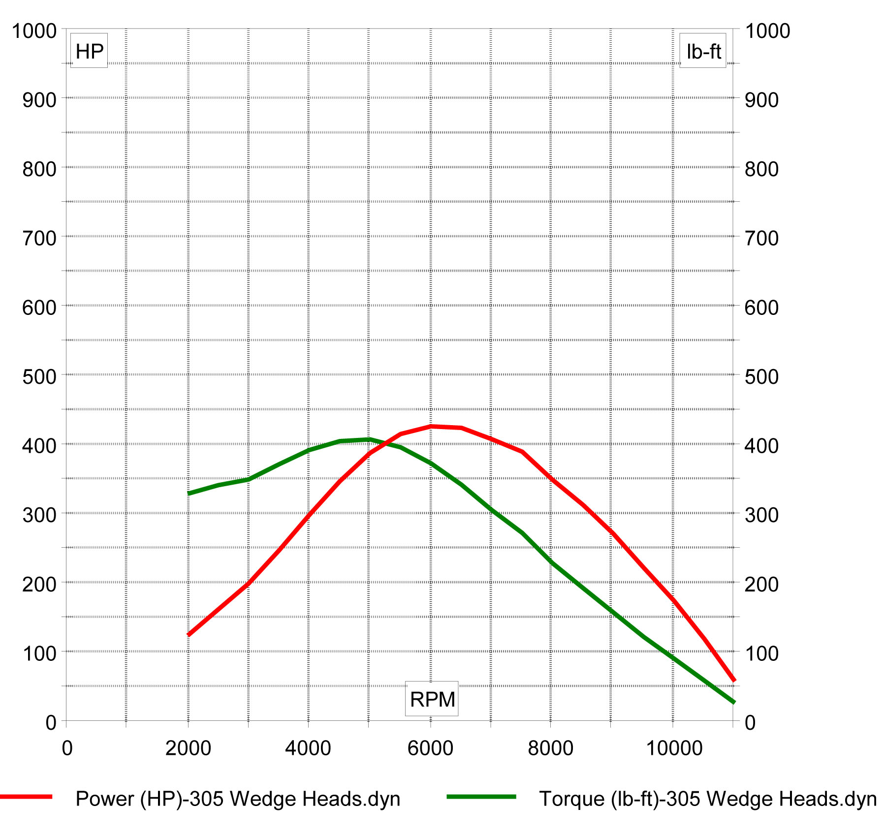

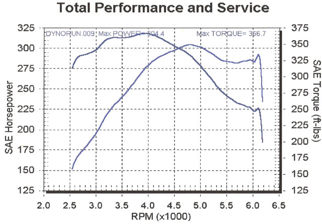

I'm refering to area under the curve. I've done the math enough to know that a curve with a bunch of peaks in it has less area under it than a smooth curve. This is simple Calc I stuff from college, Integrals of Differential equations. We want to know the area under a particular curve going from X2 to X1 in relation to the function of the curve f(x) with respect to dy. I'll post 3 dyno charts. The first one is from a stock 305, the other is from a modded 350, and the last one is what Desktop Dyno 2003 says my mods will net me on my modded 305 (334ci) which should make 427fwhp and 408fwtq. Now if you did those same mods from the 350 on the 305, the 305 would have more torque under the curve than that 350.
Originally Posted by ericjon262
and what does adding displacemant do?
I'm not saying that it phsically increases the size of the bore and stroke, I'm saying that by forcing air into the motor, you are adding cubic inches to the motors dynamic displacement.
you add FI when you can't add more cubes, or at least thats the way I'd do it, because it costs alot less to make a big inch smallblock than a FI motor esp if you go turbo.
your buddy's mildly modded 350, what kind of mods? if he put big tube headers and single plane intake, on a stock 350 than of corse he'll has less low end torque,
as for the detonation part, I read that somewhere, I had problems with my 1986 K5 blazer's 305 detonating, but it was at about 225000 miles when it left me.
I'm not saying that a 305 is a bad motor, I'm just saying that if your going to spend that kind of money on a stroker crank whats the point.
I know adding displacement increases airflow, but saying a FI add displacement isn't technically correct.
My friends mildly modded 350 IIRC: 1-5/8" headers with dual exhaust, heads, cam, intake and carb. It wasn't anything wild and he hadn't had time or money to get it all dialed in. I think the intake was single plane. I'm pretty sure he was using a Quadrajet.
I know what you're saying about the 305. But for those of us who are already considering stroking a 305, its kinda insulting when people start acting like we don't have clue as to how much its going to cost us or what our performance returns will be. Some people like to do different things because they find them interesting, not because they are cheap and easy. I guarantee you that if boring and stroking a 305 were cheap, easy, and yielded a really good return on the investment, everyone would do it.

Desktop dyno isent accurate..... It tends to inflate your numbers. It also does it based on crank horsepower. I dont really care how much power a motor makes, im much more interested in how much actually gets to the wheels. Youre also comparing completely different motors, on different dynos, thats not going to give accurate comparable results. As I said the only way to compare would be everything the same, only difference being 305 vs 350.
If the 305 made such great low end torque...... It would be much more highly regarded. The 305 does tend to make its power a couple hundred rpm lower then a 350. But it makes no difference in the real world and the 350 is better in every way. Also try at least showing dyno numbers in the same range, that 350 makes well over 100tq and horsepower more then the 305. Try adding a cam/heads to a 305, unless you get VERY mild stuff, it will show a curve, it will make more power at certain rpms, and it wont be flat.

I just made two desktop dyno models, one is a 3.735 bore (305) one is a 4 inch bore(350) the 350 outperforms eveywhere, the only variable I changed was the bore.
I tried to attach the files, but It said something about the file being invalid.
a 305 is fine for a dd, but if you want something extra, go with a 4 inch bore. be it a 302 as I described in a earlier post, or a 383, bigger bore bigger valves, more power.
