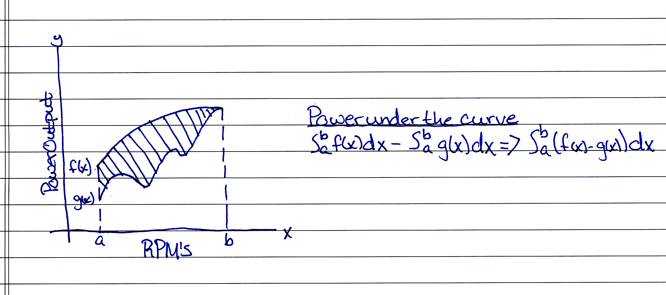

Now I confused. Because a 350 and 305 will never have the same power either under or over the curve..??? In 1987 the stock 305 TPI is 195 hp and a stock 350 TPI is 245 hp. Quit trying to compair apples and oranges. If the Cam's, axle ratios, wheel size, transmission's are different, it will throw off all your dyno's. We are aware that you already know this. If you put the same mods on the 305 and the same mods on the 350, you will notice a major increase in power over the 305 because it is restrictive.
I hope you find a good solution to this problem.
Example: You mod a 350 and get 300rwhp. You also mod a 305 and 300rwhp. Now the only way to make an informed decision on which car is going to win a race is to see which engine produces more of its power under the curve (this is assuming the cars are identical in every way except displacement).
"Power under the curve" is a mathematical definition of how much area a curve covers. I'm going to give a real basic definition of Power Under the Curve.
The line on the dyno graph that shows power output at a given rpm is called f(x) or g(x), "a" represents the lowest readable rpm, "b" represents the peak of the curve, and dx tells us that we are working on the x-axis (see pictures 1 & 2). You then take the anti-derivative of each function and plug in "b" for x and you also then plug in "a" for x. Subtract a from b and you get the area under the curve. This is a very basic definition, but it is a good way to figure out if your engine is as powerful as you think it is. Now to compare the two graphs to see how much you need to change one of the given setups. You overlay them on each other and find the area between the curves. You subtract the lower curve from the upper curve and you have the area between the curves (picture 3).
I hope this helps you understand my point of view.

Looking for the shock and awe effect as your car spanks others on the street...
Swap in a 6.6 duramax that's built to sh*t
Now that would be a jaw dropper
And guess what it would have plenty of power -- Under the curve --
Any way you slice it 283 / 302 / 305 / 327 / 350 / 383 / 377 / 400 / 427
Its still a sbc on the outside
If your looking to spend that kind of money on a 305 swap in a stock lt or ls motor. There's great power and excellent fuel mileage to boot.
Otherwise spend your money on what you want best bang for the buck 305 isn't the way to go. It's been proven time and time again.
