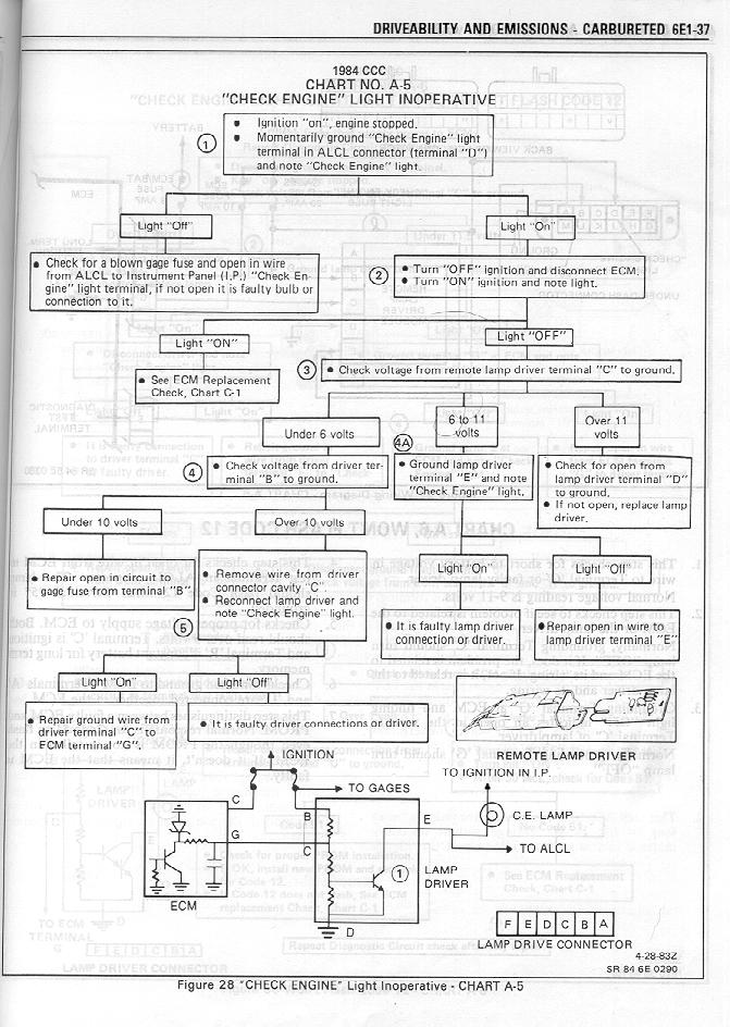

Pic from the service manual. You can see the umbrella seal on the exhaust valve. It moves up and down with the valve. When you install them just push it down until it seats with the valve guide and then it will self center itself when the valvetrain moves.

The service manual has trouble shooting for an inop Check Engine light. I'll scan them in and post the pages.

Here are the trouble shooting pages out of the factory '84 Firebird service manual. I didn't even know there was a remote light driver for the Check Engine light. I thought that was all in the ECM. I'm not sure where it is. I looked at the picture diagrams under the electrical section and there isn't anything shown in the dash pics. I know on my car there is a small light green box near the ECM that is taped to the dash frame. I wonder if that might be it.

dude that's awesome man.
I don't know what I did...but I have a check engine light now.At first it did not light at all no matter what.
I was only testing around for ground confirmation from pin A.
Was able to choke the trouble codes out of it and all seems to be well.

Code 15 is an open coolant sensor circuit. Its either a bad sensor(its in the thermostat housing) or a wiring problem
Code 41 is no distributor reference pulses to the ECM. This was probably set when the ignition module died. There is no cam sensor. The ECM gets the engine rotation information from the distributor.
First I'd try disconnecting the battery for a few minutes to clear the codes and then see if they come back again with the engine running. It takes at least five minutes for Code 15 to be set if there is a problem.
The only sensor you'll find on the back of the engine on the driver's side is a cold feed sensor on the head for the hood louver system. Its prevents the flapper door from opening until the engine is warmed up.
