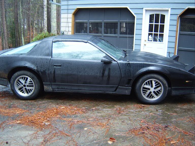

All that aside, I just recently picked up a 1986 TA. She's not pretty (don't let the picture fool you), but has great potential. Traded away a car that didn't drive for it, so it worked out.
Herein, lies the problem. I knew it had an exhaust leak. I went to have that looked at, and discovered that it has no cat converter. I live in an emissions area, so that's a problem. Illegal to sell a car to a buyer who lives in an emissions area, without current emissions. Nevermind that it's a federal offense to remove the cat.

Re: Question about my TA's Smog Equip....is she worth saving?
they all had air and a pump, its probably been removed. It may still pass inspection with out them. Does the car have tubular headers? or stock manifolds? i cant tell in the pic
Replace the cat, no biggie
as for swapping the motor into the 83, the 83 may not require emmissions testing, but it is still required to have the emmissions components.
Hope this helps

Thanks for confirming that they all had AIR/smog pump. Is that just the case for all the cars/years? Or just the TPI? Or in other words, did my '83 HO also have it? (engine was in a million pieces when I got it, so I have no way of telling)
It has tubular headers.
Also, I should have clarified one thing. If I swap the engine into the '83, it will still be getting a cat installed.
I guess I'll go ahead, and have the exhaust fixed, cat installed, and at least see where she sits on the actual test.
