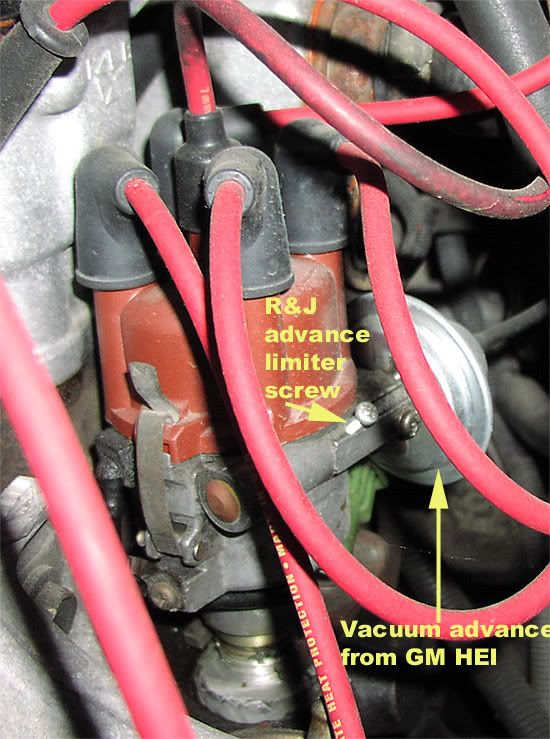

On a performance application it's best to have some adjustability in the vacuum advance mechanism. With a lot of initial advance you also need to limit the vacuum advance as well so it doesn't add as much as for a factory application. Between 10 and 15* is all you'll need from the vacuum advance.
If your vacuum advance isn't adjustable then you could just install a limiter screw to limit the travel of the advance arm.
I've had to graft vacuum advances onto other style distributors and modify them for a limited amount of advance. Here's an example of a Chevy advance mounted on a Toyota distributor installed in a Dodge Omni. The V8 part added too much advance for the 4 cylinder. Here (pic link)you can see what I'm talking about with the limiter screw. Having an adjustable style advance unit saves the trouble though.
link:
http://i165.photobucket.com/albums/u...stributor1.jpg
