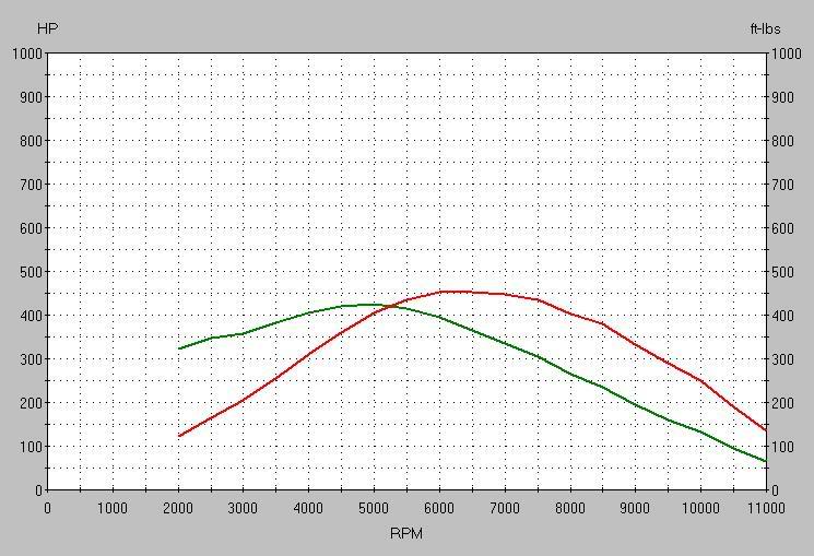

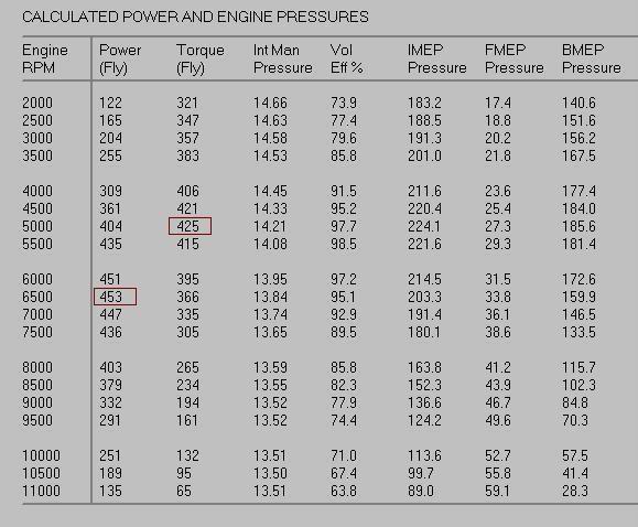

just playing around with desktop dyno. AFR190+260cam + dual plan intake+10:1 comp
at least i have an rough idea now. . .

That's about what I figured. I'm running a similiar combo in my '66 Camino and it's been dynoed at 360 rear wheel horse power with a smaller cam, .480 lift/215 duration @.050" and an older set of AFR heads. With the newer, better designed AFR's you are choosing and the bigger cam, you would have to be looking at the very least, at an additional 30 horsepower.

should i get a stall?
Old Feb 20, 2009 | 10:20 AM
wesilva's Avatar
iTrader: (35)
Posts: 1,229
From: Albuquerque, NM
Car: 1966 El Camino Custom
Transmission: 200R4
Axle/Gears: 3:73 12 bolt with Brute Strength
Re: Need help with future motor project for (road racing, autocross)
I can't help you on that. I've never run an automatic in anything but a drag car.
Old Feb 20, 2009 | 03:08 PM
Stekman's Avatar
Joined: Jul 2003
Posts: 4,803
From: Grand Rapids, MI
Car: Z28
Engine: Sb2.2 406
Transmission: Jerico 4 speed
Axle/Gears: Ford 9" 3.60
Your converter will need to compliment your cam selection, so yes, you will most likely end up needing one.
Old Feb 22, 2009 | 02:05 AM
FueledSoul's Avatar
iTrader: (18)
Joined: Dec 2007
Posts: 1,924
Likes: 12
From: Minnesota
Car: 84 camaro, 88 trans am, 98 camaro
Engine: Modded , stock, LSX modded
Transmission: 700r4, 700r4, t-56
Axle/Gears: 327, 308, 373
I talked with comp cams and they recommended a 268 grind for what i'm using the vehicle for. seems like a good cam i think im going to go with 1.6 rocker ratio to bump the lift up
