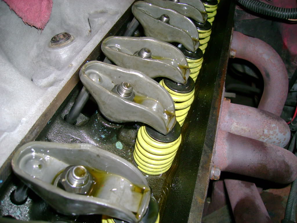

So I have over .700" clearance between the retainer and seal, my problem (I believe) turned out to be wrong retainers for my application, they didnt "center" in the valve springs, causing the springs to be able to walk side to side very slightly, since there also isnt anything at the bottom of the springs to center them either
This then caused the seals to get a little beat up after a few thousand miles.
Added new viton seals, went with the LS6 springs and comp cams retainers. So far my 'bird is running great with no smoke now.

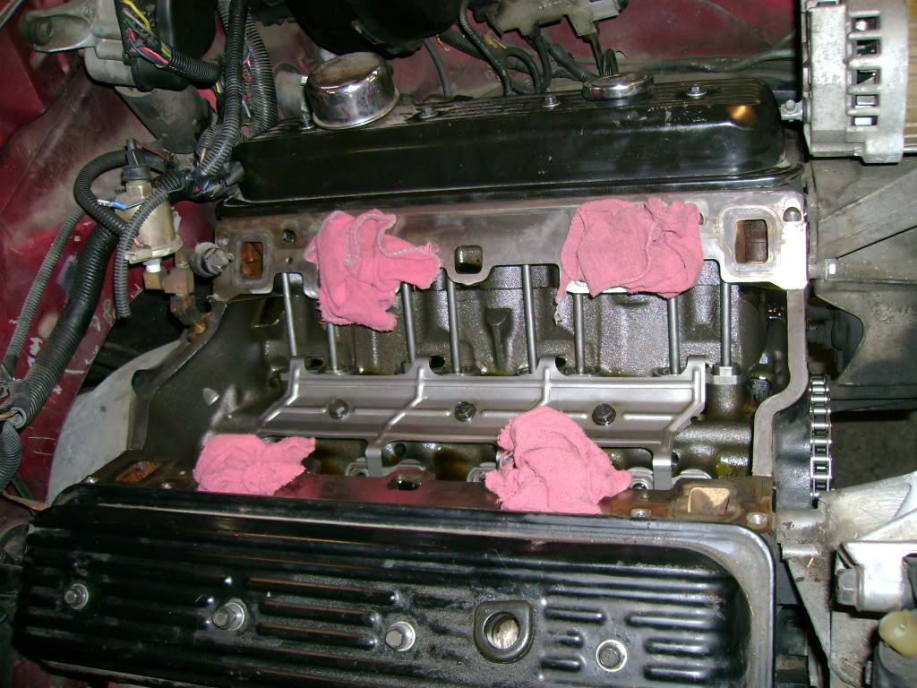

Re: 5.7 Vortec LT4 Hotcam Install Pics and Information

Did you add a spring locator on the bottom of the valve springs?

No I didn't. Figured most SBCs don't have them, I should be ok since I have retainers that actually do that job now.

The guide on the stock head located the spring at the bottom. It appears yours were cut way down in size to accommodate dual springs? The springs move alot and spin while in use. I would not feel comfortable not using locators on your setup. I am just an old dude with only six sbc engine rebuilds so take my info with a grain of salt. Please ask your machine shop.

Hmm, that hadn't occured to me.. This is my first build and the old springs were dual springs...
Almost all of the inner springs had a chunk broken off when I found them..

Originally Posted by 3rdgenmaro
Well guys, I recently installed a LT4 Hotcam into a 97 vortec motor with a ton of help from Melonhead. I figured I would post up on some part numbers and such that I ran into during the swap. I searched many different forums for help on this, so this thread is meant to be a help to anyone that decides to do the install.
First off, the motor is a carburated 97 Vortec 350 from a truck. It is in my 88 camaro with a stock 700r4. From what I have read, these motors come stock with 255hp. Or atleast that is what GM claims. The motor ran great, had decent power, but I wanted more. I wasnt looking for all out horsepower, but a good streetable cam that would work well with the rest of the engine and that would wake that motor up. I decided to go with the GM LT4 Hotcam. The cam is very streetable, has a smooth idle, and a good powerband that doesnt go too high in the rpm range. The cam is listed as NAL-24502586 (summit number) http://store.summitracing.com/partde...6&autoview=sku
It is a hydraulic roller with 1,500 - 5,800 operating range, 218/228 at .050, .492 lift with 1.5 rockers and a 112 lsa.
The main problem with the vortec heads as many people know is the lift restriction of .480 If you have the heads off the engine, I would recommend having the correct machining of the valve guide done and have screw in studs installed. However, you can make these heads work with larger lift cams without removing the heads. This is where Melonhead was a lifesaver for me. If you use the GM LS6 beehive valve springs (GM PART # 12499224), Comp Cams retainers 787-16, and change the umbrella valve seals to Sealed Power Part # ST2015, you should be able to get up to 0.550 lift. (I am currently only running .492 lift with this combination with no problems, however in the next couple months I will be swapping to 1.6 full roller rockers giving me a lift of .525.)
***5-27-14 Update: Had issues with the car smoking at idle. Suspected the valve seals. Ordered Fel-Pro SS72861 stem seals. While replacing them I found a couple of the old ones had popped up and were just riding the valve stem. Clearance with the retainer is still good, atleast with the 1.5 rockers I am running.*****
Swapping the valve springs is simple. Im not going into the details on how to swap valve springs on an assembled engine, you can find that elsewhere. I will say that the new seals go on fairly easily and if you put some oil on the inside it will help it slip on. Using an old retainer from a spring you just removed, press down on the seal until it fully seats on the bottom. you dont need to buy one of those installer tools for $30. The ls6 valvesprings are alittle tight to install sometimes. I had to put some of them under a hairdryer for a little bit for them to slip on. It was tight, but not tight enough to warrant a concern.
One of the huge downfalls of doing this swap with the engine in the car is the stock plastic timing cover. I first started by removing several of the front oil pan bolts. Most of you have pulled a timing cover in car before, so not much detail in that respect. The stock oil pan gasket is a one piece rubber style so be careful. While I was working the cover off, the bottom corner broke. Cheapest place I found was summit for replacement NAL-12562818 $23. The summit piece is built by GM and comes with gaskets and bolts. The crank position sensor holes are in the cover, but if you are using one, you must cut it out yourself.
The crank position sensor trigger wheel is pressed onto the crank in front of the crank sprocket. A screwdriver was all that was needed to pop it off. Gently pry on one side then the other until it comes off the keyway. The rest of the cam change is straight forward, pull spider, pull lifters, pull cam, reinstall cam, reinstall lifters, reinstall spider, reinstall timing gears. For reference the timing set I used was Cloyes CLO-9-1157. Also from summit.
If you take your time, you can reinstall the timing cover with the engine in the car, without dropping the oil pan. It just takes time, patience, and a steady hand. Do not get too forcefull or you will break it. From here on out it is basic reinstall. I set the hydraulic lifters at 1/2 turn.
Distributor gear. That is the big question I had. Do you have to run a bronze gear? No. Since these motors come originally with a roller cam, the stock gear will work with this cam. GM cams use a melonized distributor gear on the cam. However, if you go to an aftermarket cam, you might have to change out since they are billet. But for the GM hotcam, your old distributor gear will work.
I am running an Edelbrock Performer RPM intake with a holley 600 with vac secondaries. I have alot to do under the hood when money allows. Full roller 1.6 rockers, custom wires, custom air intake, and a basic cleanup of stuff under the hood.
The idle didnt change much. It almost sounds exactly as it always had. After some linkage issues I had, I could tell a huge difference in the motor. That cam really woke it up. I have realized now I need to change out the governer in the transmission to let first gear turn higher before shifting. I havent been able to do any tuning to it lately. The first couple of hard runs has given me a nice little noise somewhere in the driveshaft or rearend. Got to fix that first. I am running a stock converter. The only issue I have with it is that at times when you are coasting around a turn or down the road, you can feel the car want to "buck" alittle.
http://www.grandsportregistry.com/dyno.htm This is the registry for the 96 LT4 cars and the mods done with dynos done. Most show atleast 300hp at the wheels. I have not been able to dyno, but I can say it is alot more than the 255 the motor started out with.
All together I am completely happy with the swap. I have around $600 in the swap and it is definately worth it.
I will post up more as I get the time to tune. Here are a few pics.
Attachment 432510
Attachment 432511
Attachment 432512
Attachment 432513
