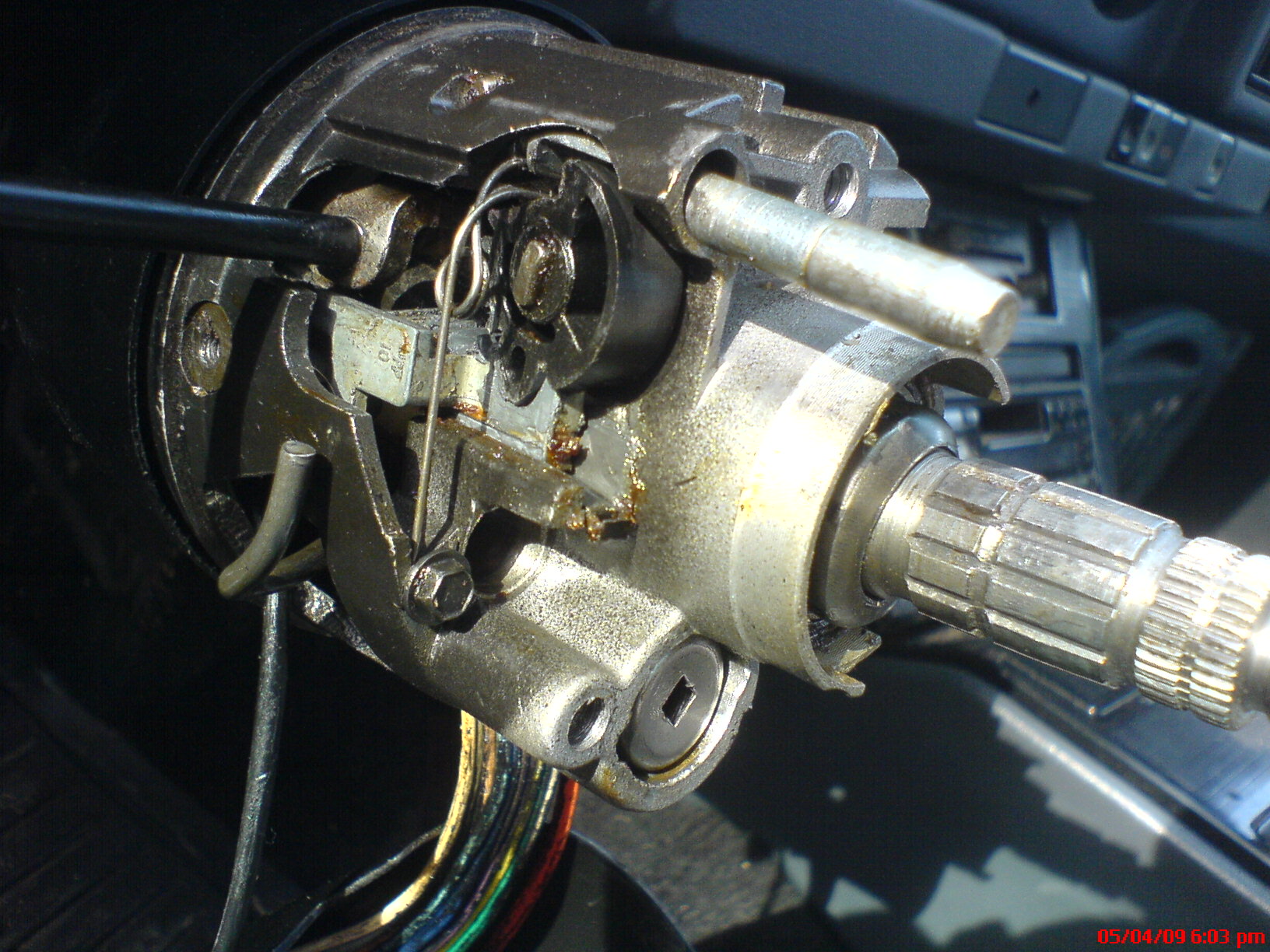

Im done tightening my tilt bolts but how do I put the the high beam actuator back?
My high beams arent working now so I took it apart again and its driving me nuts.
Theres a small metal bit I cant figure where it goes, is there a link with pics of how to put this back together properly?

http://www.fiero.nl/forum/Forum2/HTML/088020.html
Step by step how-to

Just what I needed, thank you.
