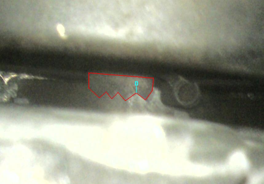

OK so heres my next question! How do you know how many degrees advanced you are. All i see is a 0 (TDC) on the timing mark. There are a few pointers next to it but how much is each degree?

Now either post a pic of it, or measure across your damper to find the diameter then buy a timing tape to match and stick it on there, or use a dial-back-to-zero timing light.

The first pic is the timing mark and the second is the first one with it outlined so its easier to see. Thanks.

peak to peak, on the little teeth, is 2 degres. peak to valley is 1 degree

unless that's a 6.75" damper with a GM tab.

The GM tabs have bigger teeth, so are 4 degrees between the little peaks.

no it should be the 8" stock chevy one or whatnot. So if i tune it for 10degrees BTDC it will be off the timing mark by a good 1/2 inch???
