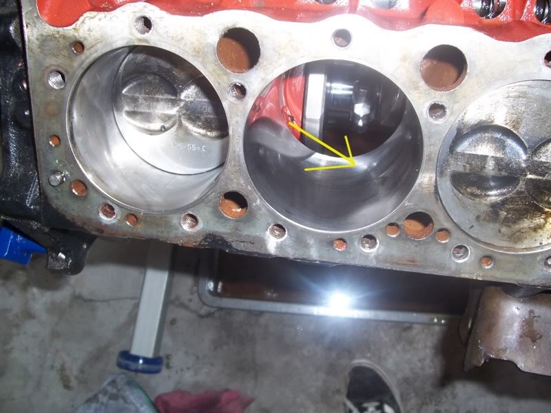

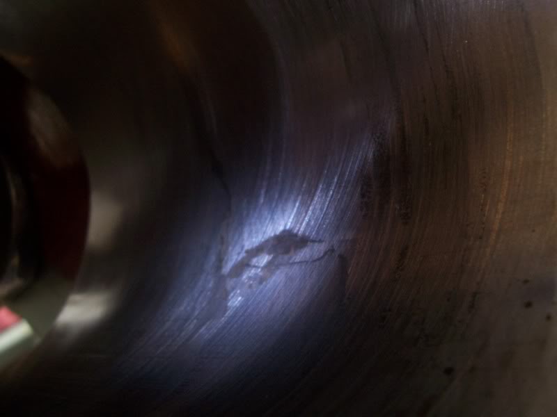

I had a .060 over motor that lasted for about 3k miles in a buddy's ride, I got it and it and rehoned it and as soon as I drove ita round the block, one of the bores cracked.
If you can get away with it, punch .010 over. There's no need to use up a block that way. The more meat you leave in the bores the more rebuilds that block can take.
And this was a nice 4-bolt block from a 72 Chevelle I think. Probably superstitiously regarded as a "desirable" casting. Didnt do much for me except cost me a bunch of money.
