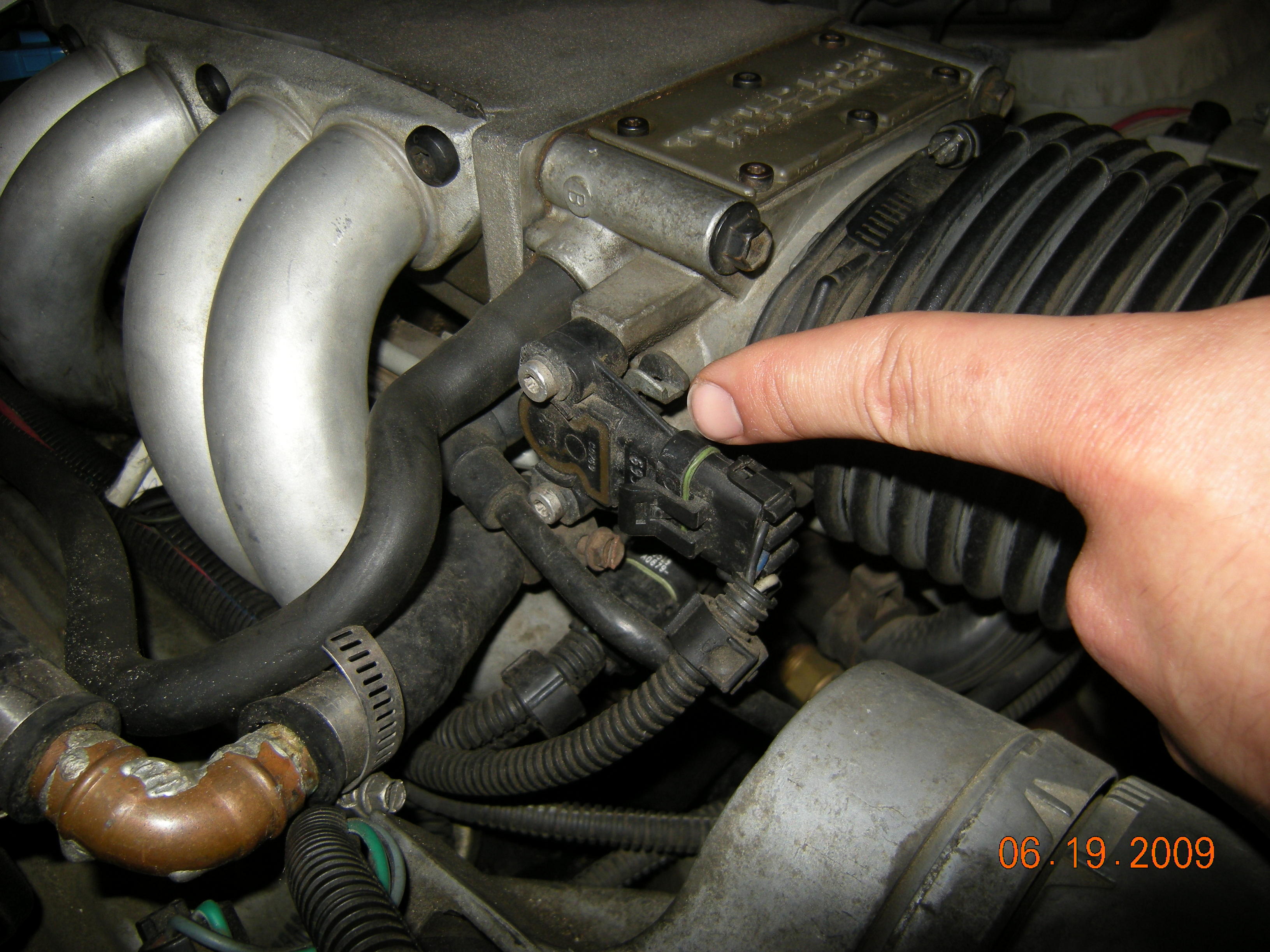

I have had a constant battery drain problem ever since I got my IROC which usually drains the battery within 6-7 days after I park it. I drove the car yesterday and todady I went into the garage to take a reading with my multimeter to see where the battery amps were. While taking the reading I noticed a clicking/scratchlike sound coming from what I believe is the Throttle Position Sensor. Im attaching two pics and I'm also going to post this in the Electronics section.
Would this be a sensor malfunction and would it cause my battery to drain within the 6-7 days?

I'd say it's more likely the thing below it (IAC). The IAC makes noise since it's a little stepper motor that screws the pintle in and out to set idle speed. It shouldn't make noise with the engine off though. I can't imagine why the TPS would make noise on its own.

Thanks for the info about the IAC, what I did in the meantime is disconnect the TPS and will check tomorrow to see if the battery is still draining.
