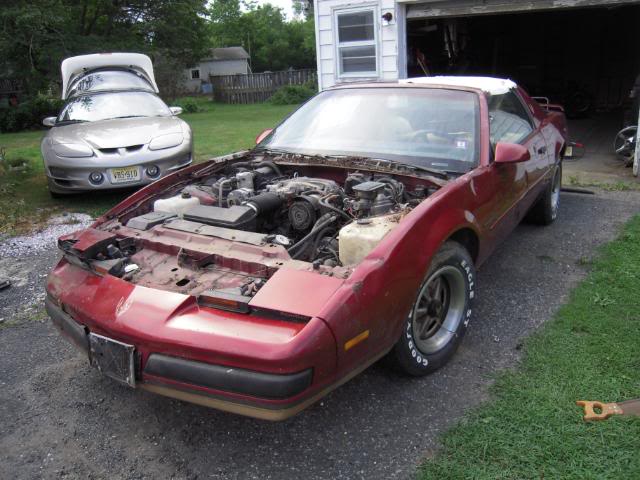

Alright, took the hood off today, that was a pain, what's SF Oil? i Took the dipstick out, the oil is blacker than anything. It says use sf oil. Also how much/ what kind of oil does the v6 87 firebird hold?

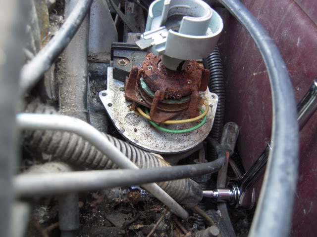

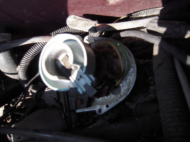

ah found it, thanks, i feel stupid should of known just follow the spark plug wires. I have the cap off and now i'm lost, i dont know what to mark... i've been taking detailed pictures of it beofre i touch anything hoping that'll help if i mess up. i can't even tell what the rotor is on this.. that plastic thing on top with a pointer sticking out? DO i have to anything before removing the assembly, mark it right? mark what..
i took this about 5 minutes ago to post here.

where are you located first off? second, mark the plastic piece uptop (rotor) with the sharpie on the housing so you know where it was pointing, then clean the distributor base and manifold and mark where the distributor lines up to the manifold, pull the retainer bolt out(under the base) and remove the distributor

millville, new jersey? alright i think i marked everything correct, does this have to exact?

I would mark where the rotor is pointing at (on the car body or on the motor) BEFORE you start to remove it, AND mark it again when you get the distributor up from its mounting pad a few inches because the rotor will turn as you pull it out. When reinstalling, line the mark that you made with the distributor up a few inches up with the rotor and as the distributor goes down to its mounting pad, the first mark you made should line up with the rotor. That will keep the motor "in time". If it is off by just one tooth on the camshaft gear that you can see down in the whole when the distributor is out, it will be "out of time" and probably will back fire, belch, spit and cough trying to start. Just some tips I learned working for an ex-Marine machanic that really knew his stuff, may he rest in peace.

One other thing - when you prime the motor, you will change the position of the oil pump shaft orientation, so you might have a hard time getting the distributor to go all the way back down when trying to reinstall. IF THAT HAPPENS, put the distributor in in any position that it will go all the way down to its pad, then pull it back up, turn the rotor left or right a half inch or so and keep reinstalling, making sure it goes all the way down to the mounting pad, again and again until your FIRST mark (the one you did before you moved ANYTHING) lines up again. It will take your patience, but just keep at it and you'll notice the rotor keeps lining up at a different spot until you get to your original mark. Was that about clear as mud? It can be a bit complicated, but not terribly complicated.

thanks. Now another stupid question, how do i get the assembly out? i have the cap off and thought the assembly came out with the removal of these two bolts, guess not so..

Originally Posted by topless87
There is a 9/16" (I believe, may be 1/2") bolt holding the distributor in and it is located at the BASE of the distributor, where it disappears into the block. It is holding down a kinda U shaped bracket that stradles the neck of the distributor. Take it out, the U shaped bracket will be loose, so hold it with your fingers or it might dissappear behind the block and take it off also, these will go back when you re-install. When you then pull up on the distributor, it should start coming up out of the block. this is when it is important to note what direction the rotor is NOW pointing, and mark that spot either on the car firewall, inner fender or motor (depending which direction it is pointing). From that point you can continue with the previous instructions for priming. Marty
Now when you say base you mean the flap thats like 2 or 3 inches from the rotor? i still cant find it, is the bolt horizontal or vertical?
Edit: i think i found it, it's just below that flap right? but how on the earth am i suppose to get it? seriously the distributor itself is blocking my access.
Edit 2: Is the bolt i need to take off the one my wrench is on? or is it the one directly behind the wrench (not in sight) kinda past the green & yellow wires?
Old Jul 30, 2009 | 09:48 PM
Zwrench's Avatar
Joined: Sep 2007
Posts: 152
From: Illinois
Car: 1987 IROC (parts car) '86 IROC
Engine: 5.7, None
Transmission: 700R4, None
Re: help; starting an engine for the first time in 8 years
From the angle of your last picture you would be able to see the bolt if you moved the conduit. Once you see it, you'll instantly know what to do.
I can't see what bolt your ratchet is on but, I know it's at the wrong angle to get the bolt you're after.

guys i didn't know i needed a distributor wrench, new problem, the 9/16 socket almost/so close fits the bolt, but 15mm hits the mark, where am i suppose to get a 15mm distributor wrench? or better yet someone come take this damn thing out for me it's been over a day now spent trying to get the thing out

LOL All automotive engines have oil filters and yours should be located on the drivers side of the block hanging down back by where the transmission bolts on. you get to it from under the car and should be visible when you pull the plug on the oilpan. YOU COULD change the oil and filter and IF you have the plugs out the motor will prime itself with the new oil but not start. You would want to crank the engine over until you see oil pressure on the dash gauge (assuming it has one). That will get fresh oil to the main and rod bearings and the camshaft, lifters and rocker arms.
