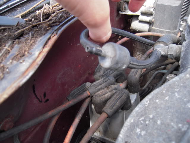

ALso what does this go to? it sucks air but idle's real low if i put my finger over it. Name:  227734da.jpg

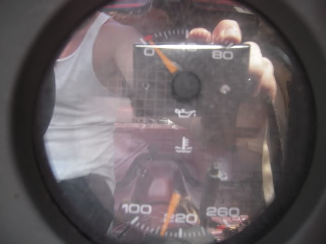

Oil pressure dropped real low too while it was running today, don't know how accurate it is seeing the fuel gauge doesn't work but all the others including the oil gauge seem to work. This is while it was running..

hmmm sounds like its starving for oil, sounded nice and quiet earlier too, hmm maybe the oil pump is on its way out?

it seems like the oil pressure fluctuates, especially after it's warmed up, is that a sign of the oil pump going out?

that oil pressure is entirely too low, probably spun a bearing

Didnt put fresh oil in her before running it? Sounds like a bearing to me...and the super low oil pressure supports that. Red on the gauge = Bad.
If it was just the gauge going wacky, without the knocking, I might say the sender is taking a crap. If you want to know for SURE what the oil pressure is, hook up a mechanical gauge and check it. But im betting bearing issues...

You have a loud rythmic knock, and hardly any oil pressure. Assuming the gauge is correct, you have a bearing issue. I really wouldnt even waste my time tearing that motor apart...unless you are purely curious. If you are set on fixing that car up, pick up another v6 motor/block and swap it in. Thats a fairly simple process as far as motor work/repairs go. Or...rip out the drivetrain, and swap in a v8 if you are feeling ambitious.

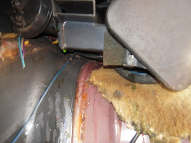

NEW ISSUE! heater core blockage

need to pull the heater core? is this something that you can pull or fix or needs to be replaced?

That looks like a heater core leak. Thats a fun job to fix. If you want to keep it from leaking and avoid fixing it right now, just unhook the hoses, and either connect them together or plug them. Im not positive on how the v6 cars are set up for coolant flow. But I would avoid running it with the core hooked up because its just gonna keep putting coolant inside the car.
J.
