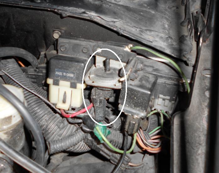

What engine sensor is this? (pictures attached)

I am still confused about what this is and what it does? I have read the post, but still not sure. Mine has a hose running from the top of this thing to a port on the intake manifold. There is no hole in the top of this thing where the hose fits on. Looks like a solid black plastic neck. Underneath it there is a brown wire clip to it and a white plastic stem that hangs down. The post said something about running the vacuum accessories. Is there a part number, what vacuum accessories is it running and what is the white stem underneath it for. Thank you....

I haven't seen this before, at least that I remember. The 84 L69 TA would have had a vacuum operated air flap in the hood that this may be. Export models would have a mechanical qjet and used a vacuum switch for the lockup.
You say the hose runs from the top of this to a vacuum source but it's not connected and won't connect?

If you look on the first page of this post, under response #18 & #19 a couple of members (Ozz1967 and Shinobi'sZ) are having a discussion about it.
The hose is off in my picture, but normally it has a hose connected to the top that runs to a port on the intake manifold behind the carb. I was thinking it was the switch for the hood flap, but the way they talk about it in their response #18 and #19 it sounds like something else.

Wow, I must have posted that without zooming into the pic. That's definitely not the check valve for the vacuum system. I'm thinking hood flap switch but it's been like 20 years since I've seen one. Hard enough to remember what I had for breakfast anymore.

Looks like you are right on hood flap switch. I started another post since this one was so old.

Transmission Conv. Vacuum Switch. It helps the transmission to shift using vacuum pressure.

Map sensor. It measures intake manifold pressure. It is suppose to connect to a vacuum line that connects to the rear of carb or tbi air filter riser/spacer nozzle. 100% accurate. The new carburetor was not adjusted for your vehicle and camshaft profile. Vac gauge should be showing 16-20hg with Q-jet (E4ME). Set should be 3 turns from seat on IAB screw, and 3 1/2 turns from seat on both front idle mix screws. That should give you a good Idle and starting point so you can get it dialed in or fine tuned.
