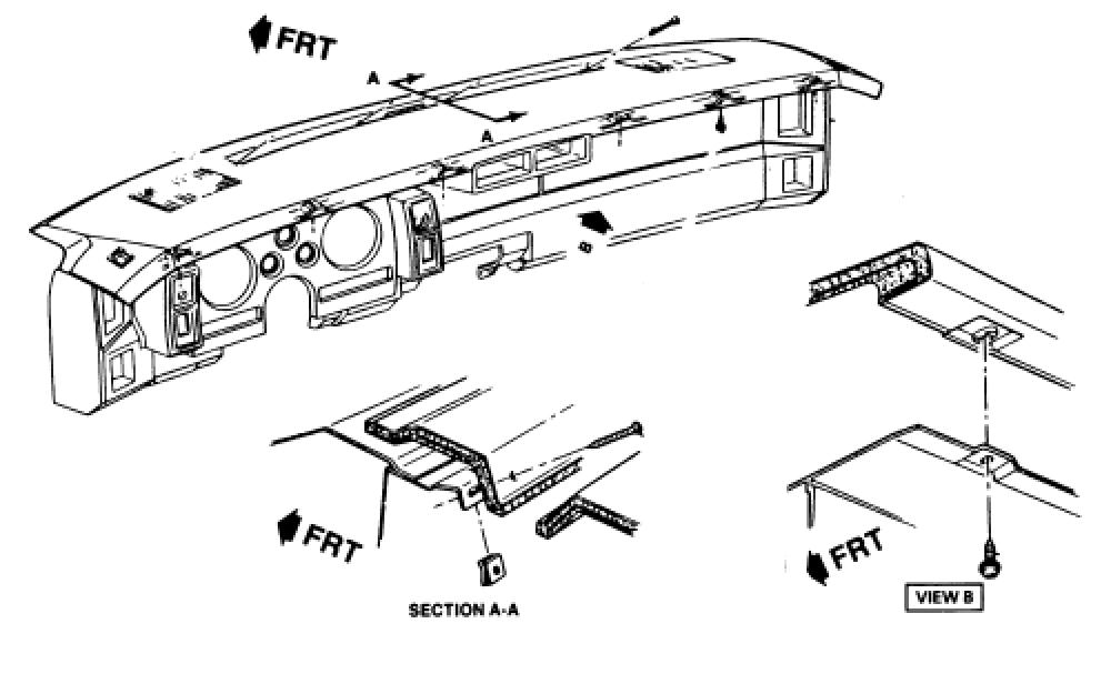

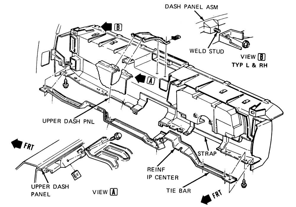

So what I wanted to know is, does anyone have a diagram, or know where all the bolts are to pull the dash out, do I need to take my whole panel for the gauges out?
I had the whole cover of the dash off, and got down to where the AC and heater ducts are, I just can't get the bigger middle duct out without pulling out the whole dash, for some reason.
This was all necessary anyway though, I took at least 5 pounds out of the car by pulling the speakers, which I've been wanting to do for a while, I heard the smell of the dead mice goes away in about 4 days, but I really don't want a skeleton in there. So please someone, give me some clear directions of how to pull the whole dash, without cracking anything, or a diagram of where every bolt is, I thought I had every single one when I pulled the top of the dash off, that covers the speakers and the windshield defroster cutouts.

ive ripped the dash out a few times mostly for heater core replacments... its a pain, u gotta take the dash pad off. then take out the center dash(shifter part) and the radio part of the dash. then u need to look around for all the bolts that bolt the dash frame down. theres a bunch of them. they will be bigger bolts but when u get them out keep pullin on the dash untill u figure out where all the bolts are and take them out... this will alow u to pull the dash out a few inches to work on it.

I've got that dash cover off already, I think you figured it out for me customblackbird, I've had that whole part that holds the radio out before, when I took the radio it's self out, I never would of guessed that there were more bolts holding the dash together in there.
