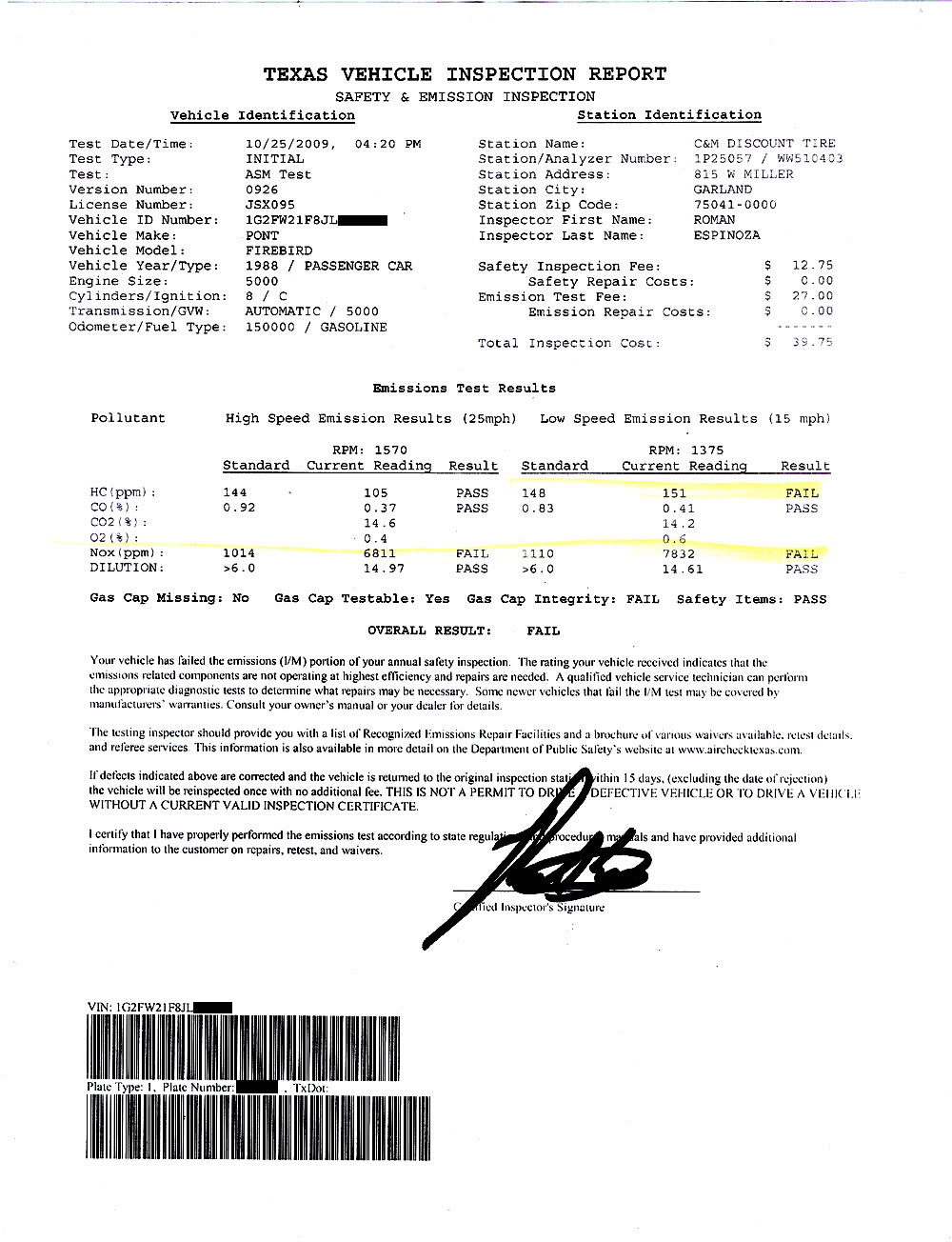

what were the other numbers?

Here's the full printout. The HC was a little high, but that's probably due to my ford 19# injectors. I can fix that with a tune. Also, the gas cap failed, but that's easily replaceable.
