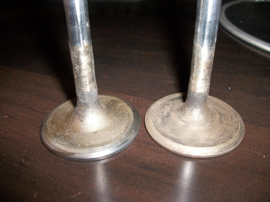

Finally found the problem! All four intake valves on that head are shot. I flipped the head upside down and put gas in the valve chambers and they leaked like crazy. The valve seats in the head still looked good, so I took one of the good intake valves out of the other head and put it in and did the gas test again. It didn't hardly leak at all, little seepping. Does anyone know what would have caused these intake valves to do this? And if the seats are still good could I get away with just lapping four new intake valves in?
The valve on the left is the bad one, the right is a good one.
