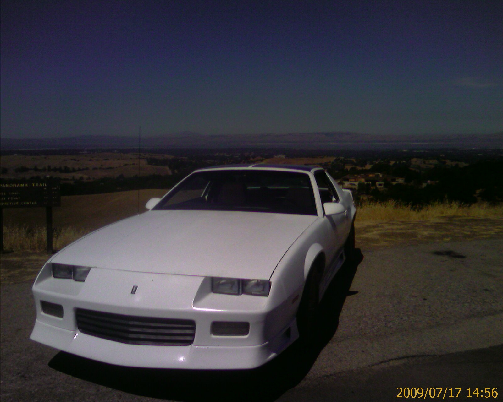

oh and i didnt get it as a gift, i bought it about a few weeks before thanksgiving for 500. it needs alot of body and interior work and since i cant drive it yet i wanted to fix it up and make it nice before i get on the road. the person that had it b4 i could tell had no idea what they were doing, (less then me) its a good project car, and hey, it runs =] lol
That sounds oh sooo familiar.... $500, beat up front end, cigarette burned interior, and it didnt run.
Im no help in this field because well...Im 16 and I also have the same question as you. :P
Attached Thumbnails How can i make my 1992 305 camaro rs faster?-camaro-orig-pos-2.jpg   How can i make my 1992 305 camaro rs faster?-image_00068.jpg
