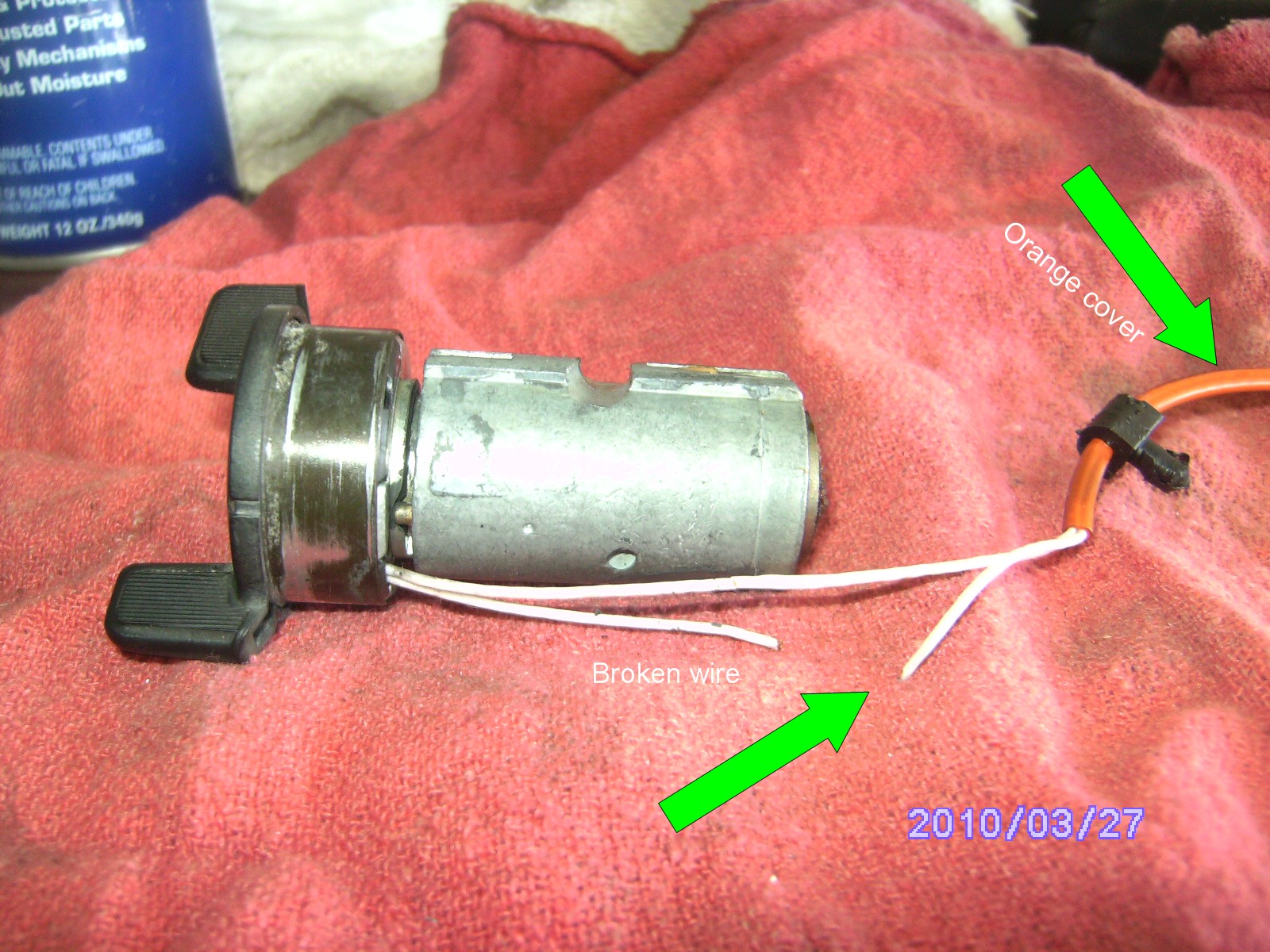

Soooo....I'm chillin' at home on a weeks leave. Got the GTA running, Trans Am is running, and still working the '91 issue. So I get bored and start looking for wires again. I find two white wires wrapped in an orange cover, but tagged with an warning label that attaches it to the airbag lines. I break out the volt meter and I get no continuaty (sp) on the line. Could it be the mysterious broken wire on the lock cylinder that I am looking for? See for yourself.
Attached Thumbnails 91 Firebird, 305 TBI, wont start.....-airbag-wiring.jpg   91 Firebird, 305 TBI, wont start.....-lock-assembly.jpg   91 Firebird, 305 TBI, wont start.....-lock-cylinder.jpg

I went to O'reillys and purchased a new lock cylinder. Came with a key blank but no keys with a chip. You have to take the blank to the dealership. Sooo...I fixed the wires on the current lock cyl and fed everything back down the steering column with two newer and more protected wires. Checked the resistance at the bottom of the column and I still get .871 on the key, so all is well on that end. However, no start but now the security light flashes on for about 2 seconds. I will tackle a little more tomorrow.

Put everything back together and still have the same resistance at the column. Now when I turn the key, I hear a clicking sound in the left front kick panel. It appears to be a start relay. I will stop by the dealership tomorrow and see if I can track it down.

Hey, I'm back. A little Bronchitis couldn't keep me down. Anyway, located the relay in the kick panel. VATS relay according to the dealership parts guy. (Who by the way has been able to find anything that I need for the 3rd gens.) I replace the relay and "viola" she starts. What are the odds that the problem was the ignition key and the relay? at the same time?
