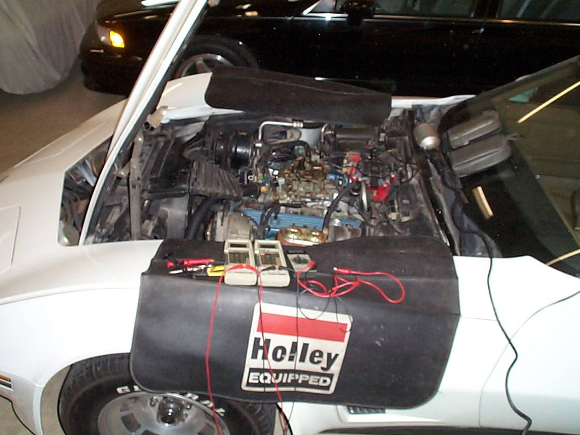

Yes alot of them! This is the engine that came out of my truck to replace the 250 inline 6 in the wife's Apollo. Yeah a BBC looks too good under the hood of my truck! 383 with 416's it has 1.94 vales with some mild porting done. Has no issues running pulls very well to 6800 the few dozen time I spun it that high. That said I did have some issue with spark curve in the truck and pinging with crap gas. Seems that all went away in the Buick less weight.
Attached Thumbnails Has anyone actually tried 305 Heads on a 350 block-apollo.jpg
