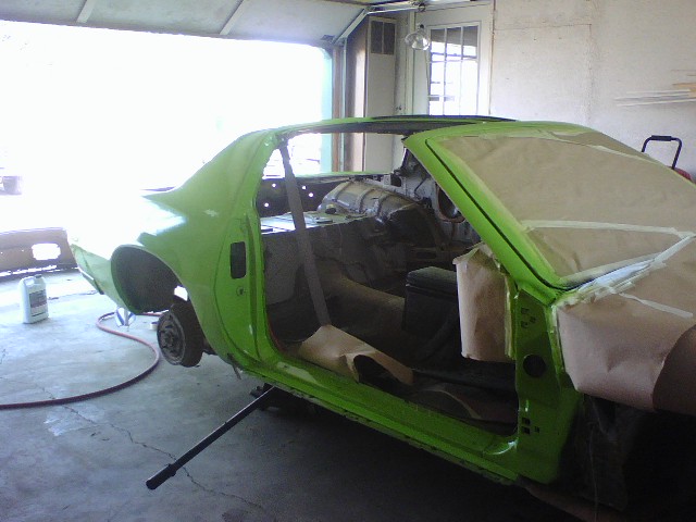

thats the new motor replacing the 305.
The world needs more green camaros, I'll be awaiting more pics when it's all reassembled.
