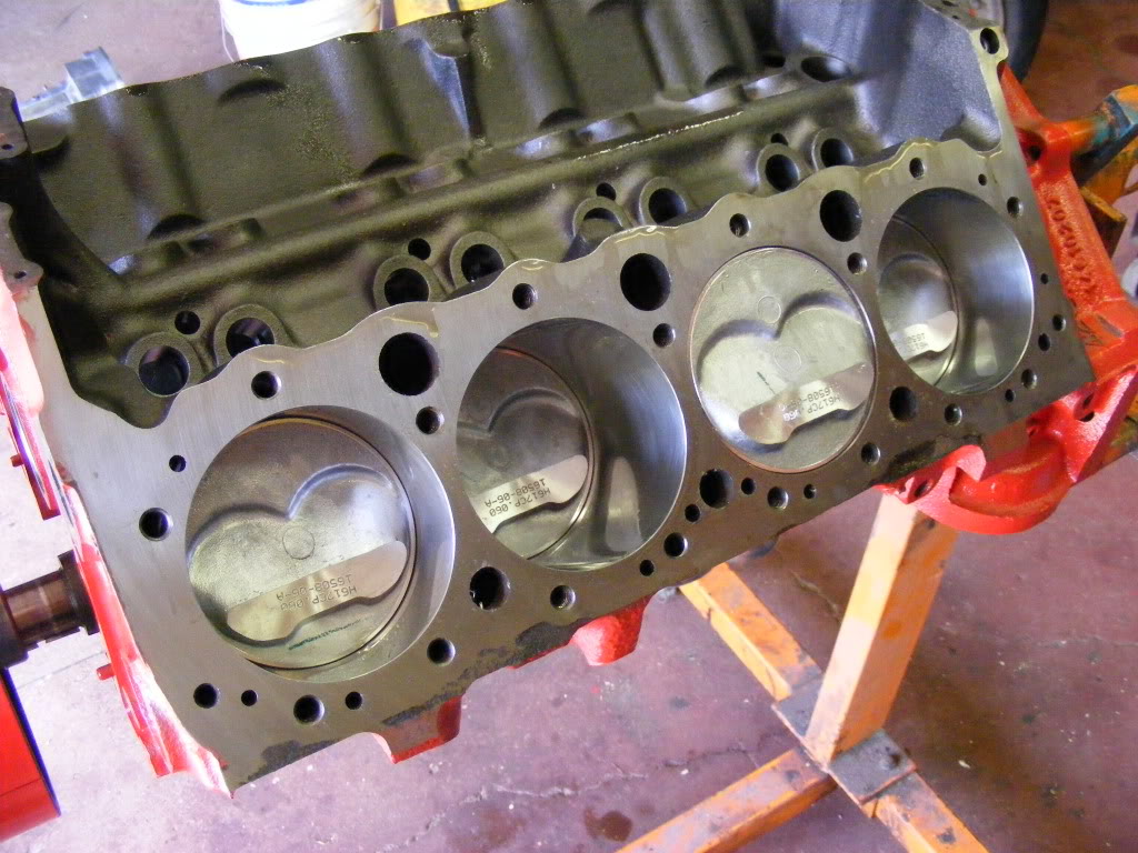

Pics of what we're working with:
This is a street engine that sees the track quite a bit during the season. Goes 8.8x @ between 80-82mph on street tires currently. Driveability is not a huge concern. Any suggestions?
