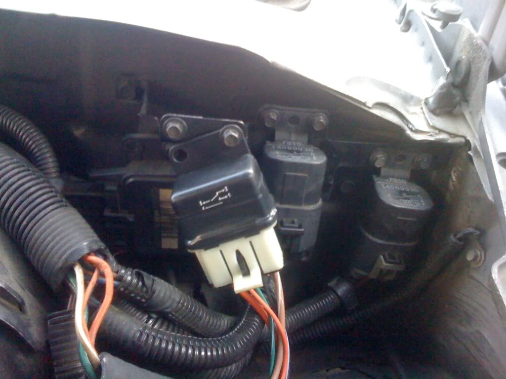

4. No voltage in MAF burnoff relay, Term D. Speaking of which, I have a few picks, can anyone tell me what relay is the burnoff? I unplugged each of the individually (staring next to engine and working to fender, one unplugged and 2 connected) and the car started each time. Only the middle relay threw a code. Didn't check to see what it was.

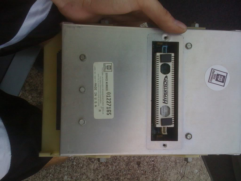

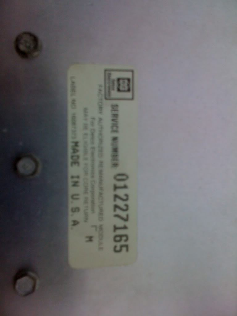

Removed the computer and found out it was a rebuilt one. Knew about the hypertech chip but there is what looks like melted glue on the circuit board. Pick also included. Sorry about the quality, they are from my phone.

The MAF burnoff relay I replaced (along with the connector) was part #10094701 the first next to the engine. I figured the car would not start or keep running with the fuel pump relay disconnected but at one point that relay was unplugged and ran fine. So which relay is which?
Car is idling a little better but still problems. Starting is fine, idle ok. Putting in in gear is ok, hitting the gas to pull out into traffic the car almost dies. Let of the gas idle is ok, hit the gas again and there is zero power, engine bogs down horrible. Pumping the gas or holding the pedal down will eventually cause power to return but the car launches forward. SES will light. When the engine eventually gets warm this "mostly" goes away. Computer throws a code 33 still. I have no clue what's going on. Any help would be greatly appreciated!
